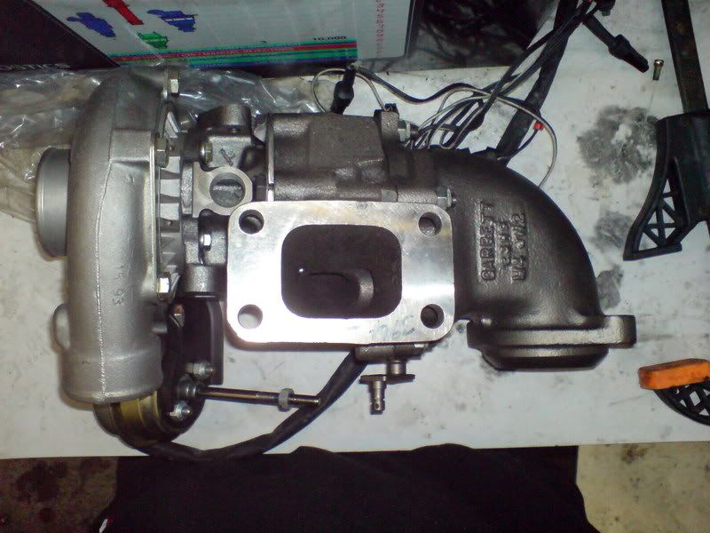

Why the fuck did he not just fit a MG Turbo manifold?
Does the Cosworth T3 not have an internal wastegate?
i think it does, and the external one looks a little chav,

As far as I know, this is an Escort T3. Obviously, it does have an internal wastegate
On 30th Apr, 2010 Rod S said:
Gary's description is best
I need one of those Actuator brackets, will it fit the GT17 compressor housing bolt spacing?
