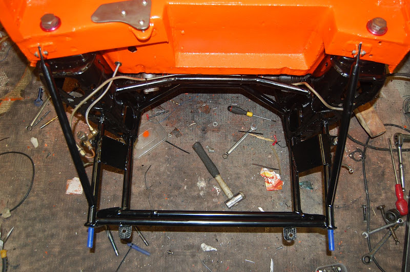

I weighed a totally bare subframe and iirc it weighed in at 16kg. The frame as you see it, with brace bars and solid floor mounts its about 12kgs. The saving isnt huge, as most of the weight appears to be in the towers. But the stiffness is way better, i stood on the front of a standard subby and grabbed the towers and could flex it real easy. I do the same with mine and it doesnt move! Feels really strong. Ill be keeping an eye on all the welds ect in the coming months to ensure nothings being stressed.

tbh it wasnt that hard to do. Easier than drilling 10 million holes in one!

ive been thinking about the same mike, i have always wanted one of carls subframes but i like dougnuts over coilovers and i dont have pockets that deep, hybrid orginal/tubular subframe was the next best thing imo
Having seen it in the flesh, mike's frame is a nice bit of kit. Very light in comparision to a standard one. Chances are I will plagerise his work...

i like that very much mike, what tube did you use?
CFS 23mm 2.03mm wall

Certainly looks nice, and light, but is it really as rigid as a standard frame? when I look at it I can't help get the feeling that its not enough. Its just a feeling though and if you're happy, what does it matter :)
On 24th May, 2010 MikeRace said:
I had my doubts when welding it all up but you really can feel the difference. I had carl take a look and I added some supports underneath to be on the safe side.

Did you need that hammer to make it fit *hehe!*
