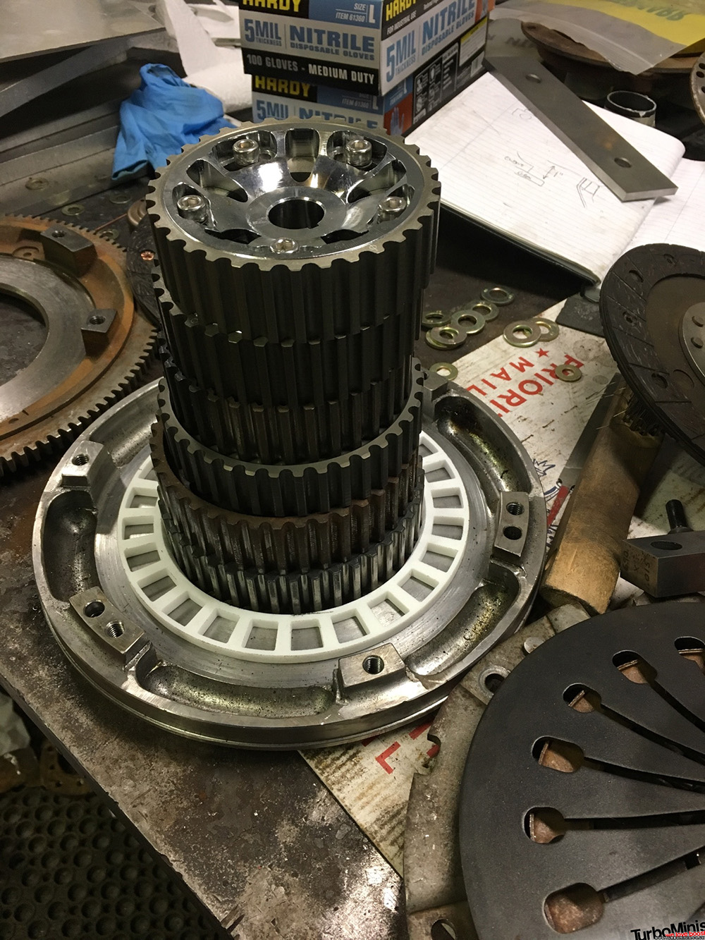

I went into my garage and pulled out my stack of OEM and aftermarket pulleys.

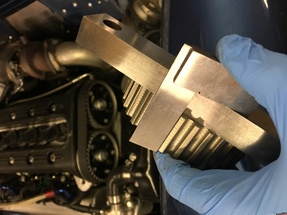

I then did a simple test using a parallel and one of my “special occasion only” high precision squares.
All but one of them, displayed no rocking of the square. The teeth are, to all intents, normal to the turned face. I repeated several times around, on both sides of the teeth. The one that showed a little rocking has mostly straight teeth, but one or two are off. I can repeat the test and get the same results on the same teeth.
I then repeated the test, in situ, of my current installed pulleys, and the square rocks. Repeated it a few times on both sides, definitely rocking present...

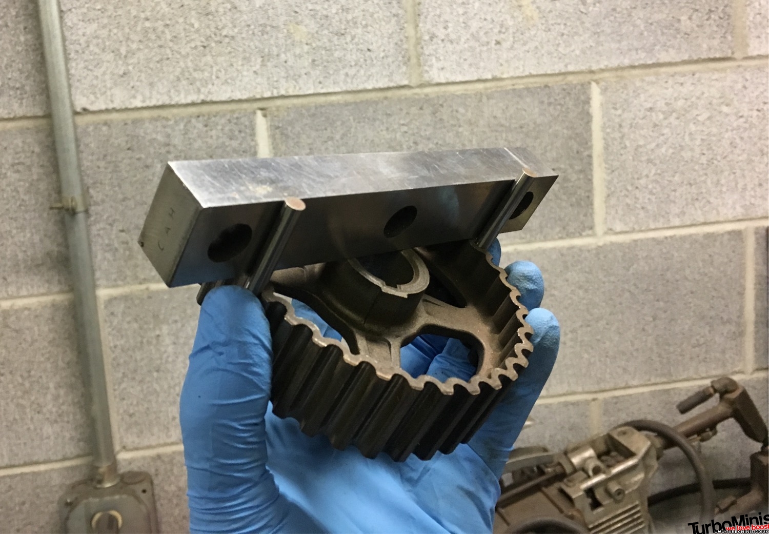

I then came up with what I think is an even better test.
Using two pins gauges (I used .211 and .212”) holding them on almost opposite teeth like this pic, and resting a rigid parallel across them, every OEM and my aftermarket B18 pulleys are perfect. The one I saw a little rocking on allows the parallel to rock in every position, but in some positions has a LOT of angular offset. I also measured over the pins at each face of the pulley, and it is parallel (so the pulley is not tapered), it’s just skewed.
I’ll repeat when the engine is next out, but may as well pick up another pair of pulleys I guess (a different type) and inspect squareness before installing... I see more rocking with the square on my installed pulleys than the “worst” aftermarket one I have in my stack after all.
