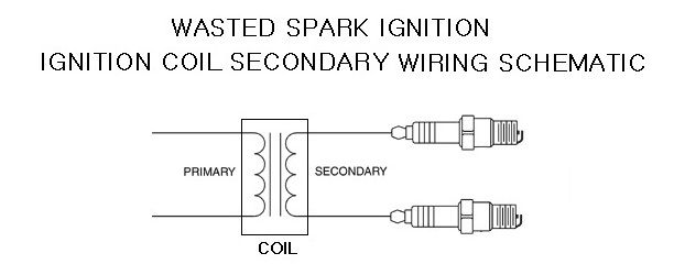

Well, that does sound odd, what exactly is the ignotion setup? Std Coil and Dizzy? wasted spark? Dizzy with ECU driving the coil?
If its wasted spark, then that would account for 2 sparks per rev, but they should all be doing the same,
If its a dizzy, I would look at the alignment of the dizzy cap/ rotor arm, could it be cross firing
other than that check aout all the HT leads and connections and resistances,
JackZwiebel
113 Posts
Member #: 11786
It is the specialist components ECU with a wasted spark ignition.
With my (very basic) electrical understanding there should be a spark at either both cylinders or at none - its odd that one fires and one doesnt.
Thats why i think its the coil pack - maybe a short between the two coils.
Since i tried other new plugs already, i will next try my old HT leads and if it doesnt help change the coil pack.
It has to be one of these parts since the ECU obviously gives the right signal, since 1 and 3 are fireing perfectly fine.

Aren't 2 & 4 normally on the same coil?
15300 Posts
Usually 1/4 and 2/3.
with the coil packs they can do funny stuff as they are ( ususally) a single double ended coil, so if one end has a problem it "can" affect the spark on the other end of that coil.
oh also SC use a generic ford coil, so nothing odd there.
Edited by Joe C on 9th Aug, 2019.
What kind of timing light are you using ???
If it's an inductive one (that you just fit over the outside of the HT lead) look for an arrow on the jaws of it.
The Ford wasted spark system is quite bizzare because the double ended coils put a positive voltage to one plug and a negative to the other.
This always means the spark energy is different - so you can get a misfire on one plug on one end of the coil and not on the other plug at the other end of the same coil - but if your little arrow on the timing light "clamp" is facing the wrong way it may also not work properly.

I checked the direction from the timing light and put it on the same direction at every cylinder. The question that came to my mind afterwards is: Do i have to put it on the wrong way around on two cylinders? .... since they are on opposite sides of the coil?
