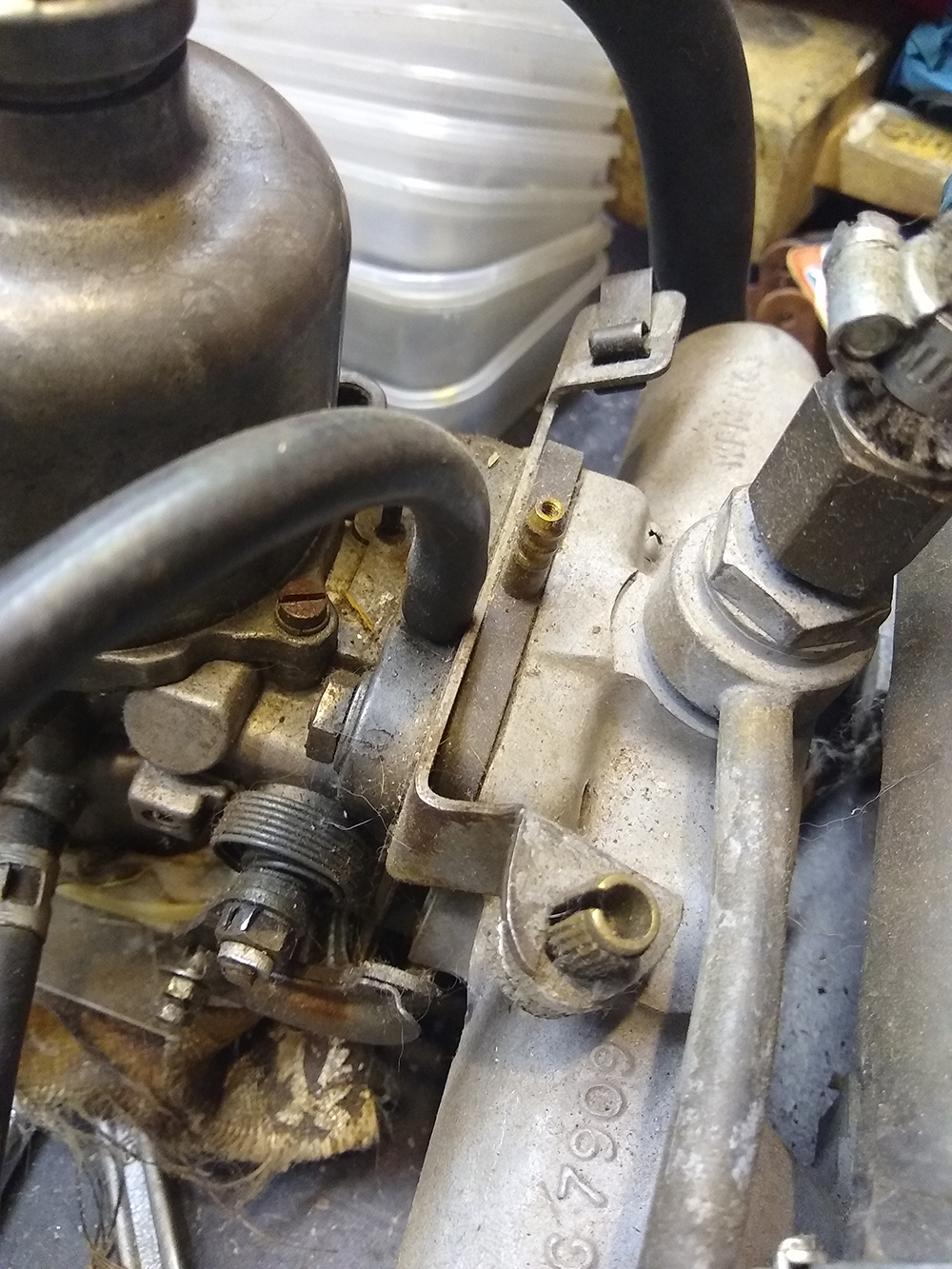

@MetroTurbo: do you mean this connection?

I assume by that photo your car is left hand drive and you have servo assistance connected for your brakes?
There is a round flat spot on the manifold / to the right of the SG casting no', that would be a suitable position to drill tap.

@shane: yes my car is lhd and a servo is connected. I already assumed the flat spot would a suitable place.
I’m considering @metroturbo’s option, is that a good option or is a newly drilled and tapped separate connection much better?
