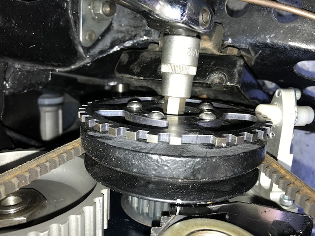

I did venture out today to set the engine to top dead center and to see where the position of the missing tooth on the trigger wheel is in relation to it. But that fell flat on it's face when I realised that I can't get a spanner on the crank pully bolt to turn the engine over without removing the entire cooling system... Didn't fancy doing that in 1 degree weather so I retreated back inside in a bit of a huff...
put it in gear and rock the car forward or back if you can't get to the crank pully bolt.
4310 Posts
Although the force racing conversion kit I had to also make a TDC pointer. The following might be helpful as reference to check the trigger wheel is roughly where it should be.
IMG_1257 by , on Flickr
