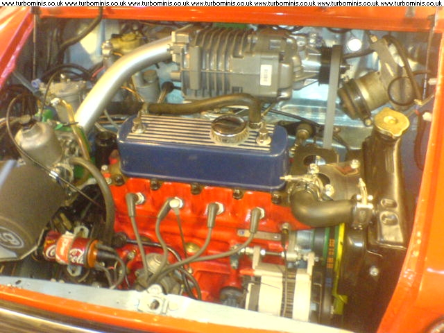

TurboDave16V
Err - Isn't it an oversized Eaton blower with a suckthru SU - unless you've done something different????
turbochargedstu
830 Posts
Member #: 908
gateshead
its running an aston db7 blower on a semi race engine jimster. got it running fine when other said it couldnt be done. pretty sure its the only one thats runs this. pulls like a train and sounds pure sex!!! hopefully will be taking it to minis v beetles for a blast if i can map the ecu in time. cheers for the comment jimster
balls to the blower!!!
This is it I think. Nice install. Don't know much about superchargers, looks a bit oldskool, and fucking massive. What were people saying was impossibe then?

evryone said it was too big to use and the engine wouldnt run. the displacement is 1.5ltr per revolution and its designed to fit a 4 to 7 ltr engine. i got it on a 1330! anyway, this isnt my thread, its about simons beastie so much respect going in that direction. bravo chap!!!!!!!!!!!!!!

changed it a bit since that pic was took now. got no dizzy due to the megajolt kit and i have an oil pipe wrapped around the end of the manifold next to the carb to put some heat into the manifold as it tries to ice up! a cheeky stabiliser is fitted from the blower to the top rocker box stud too
