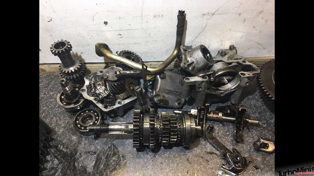

Current state is:
- Gearbox out for new baulk rings
- fitting an ATB
- Quick check over bearings etc
- Fit some parts I’ve had for ages, but not inclined to fit while it was in one piece.
- Check wear on clutch
- Tidy up the bulkhead and engine bay in general.
I think that’s it.
That art right there

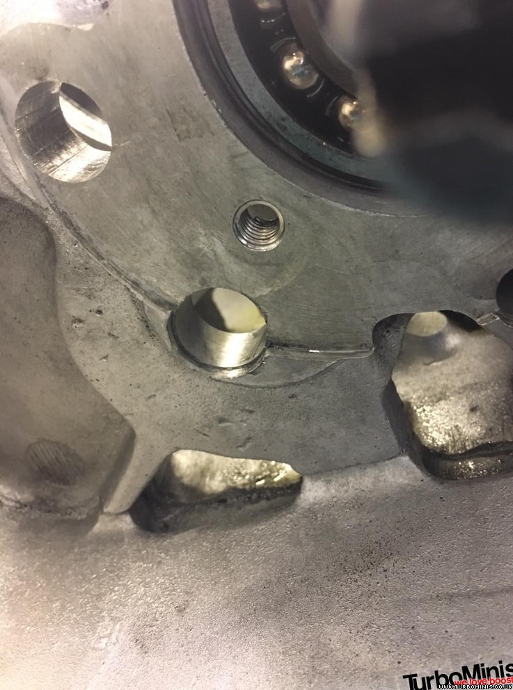

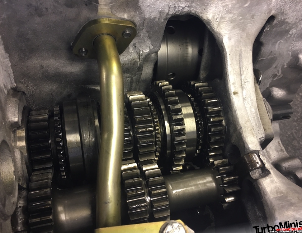

Bit more progress. New Minispares competition baulk rings fitted. Small hold up with one of the bearing retainer threads stripping. This was quickly fixed with a helicoil. Just preloading the diff bearings left to do and it’s ready to be slapped back onto the engine.

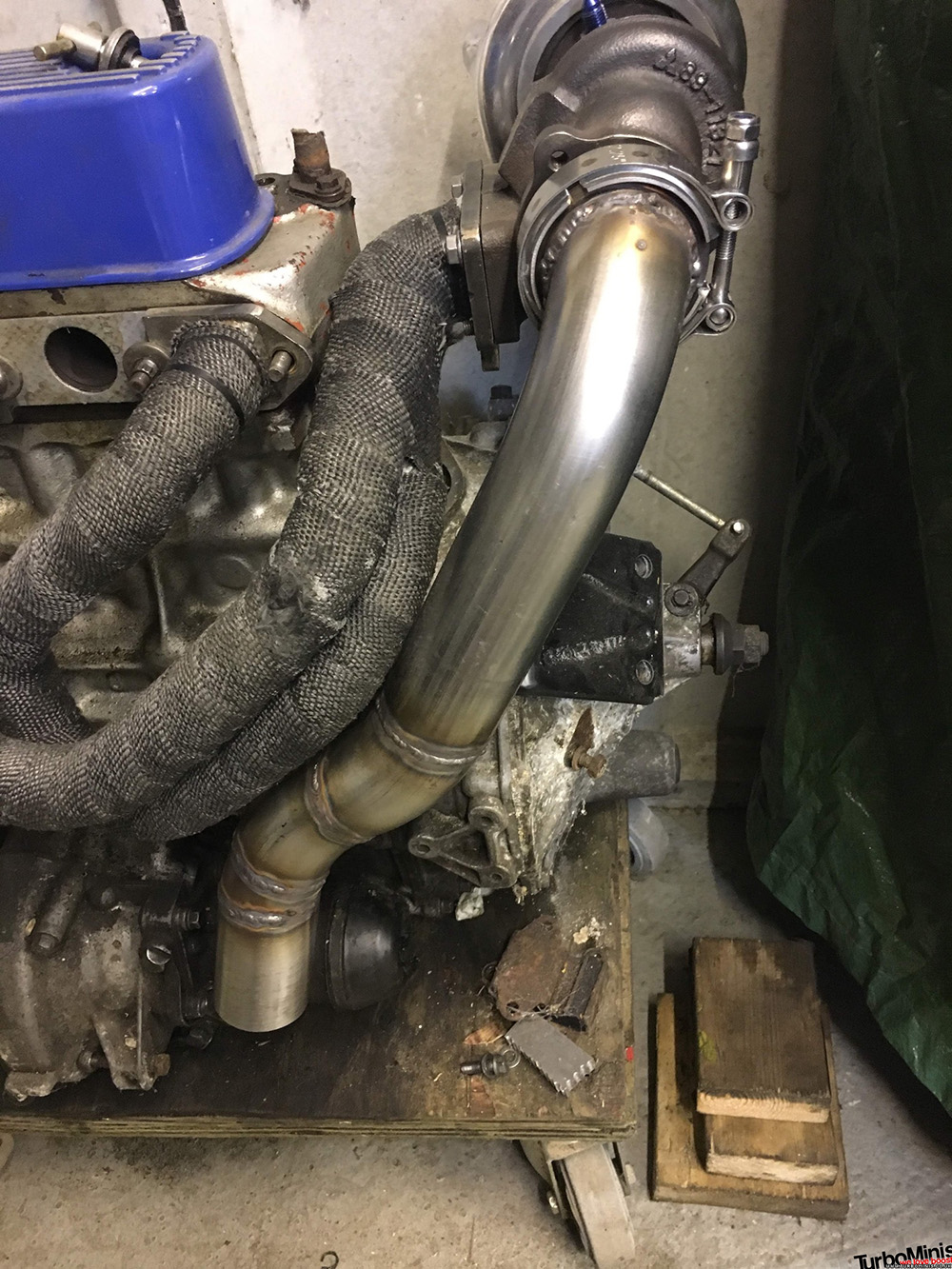

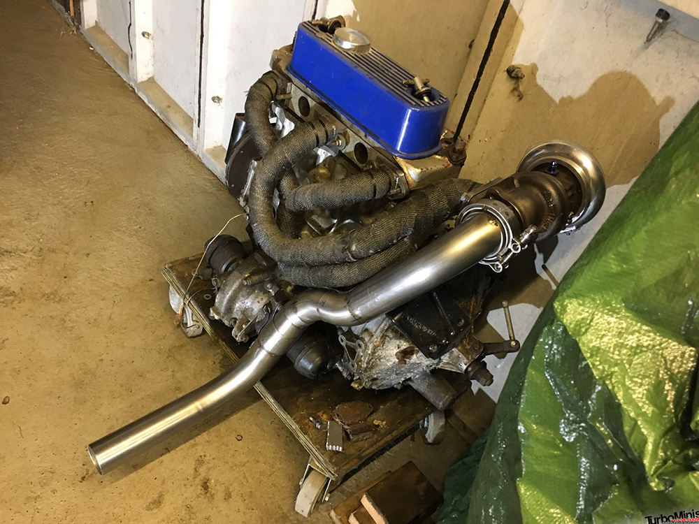

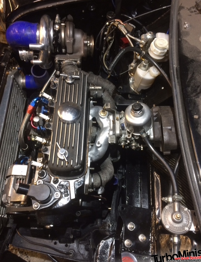

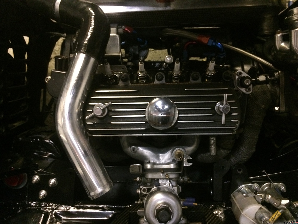

Looks like Mine. I only have one problem. Routing that exhaust back down.
I’ve struggled, but the zorst now fits. I had to use button heads for the slave bracket and notch the subframe a bit to make room.

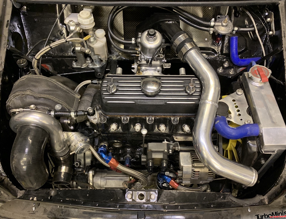

Well, this is taking flipping ages!
Exhaust is all done, most of the plumbing is done. There’s just a few breathers to sort and putting the last bits back together.

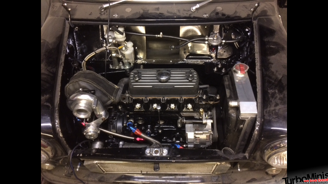

Looks the business! Much changed? New turbo to?
TD04 turbo, ATB and a general freshen-up.
All new stainless 2.25” exhaust and manifold

I'm wondering how you've fitted the downpipe because that looks like a struggle
It went in ok. Slightly tricky towards the lot joint.

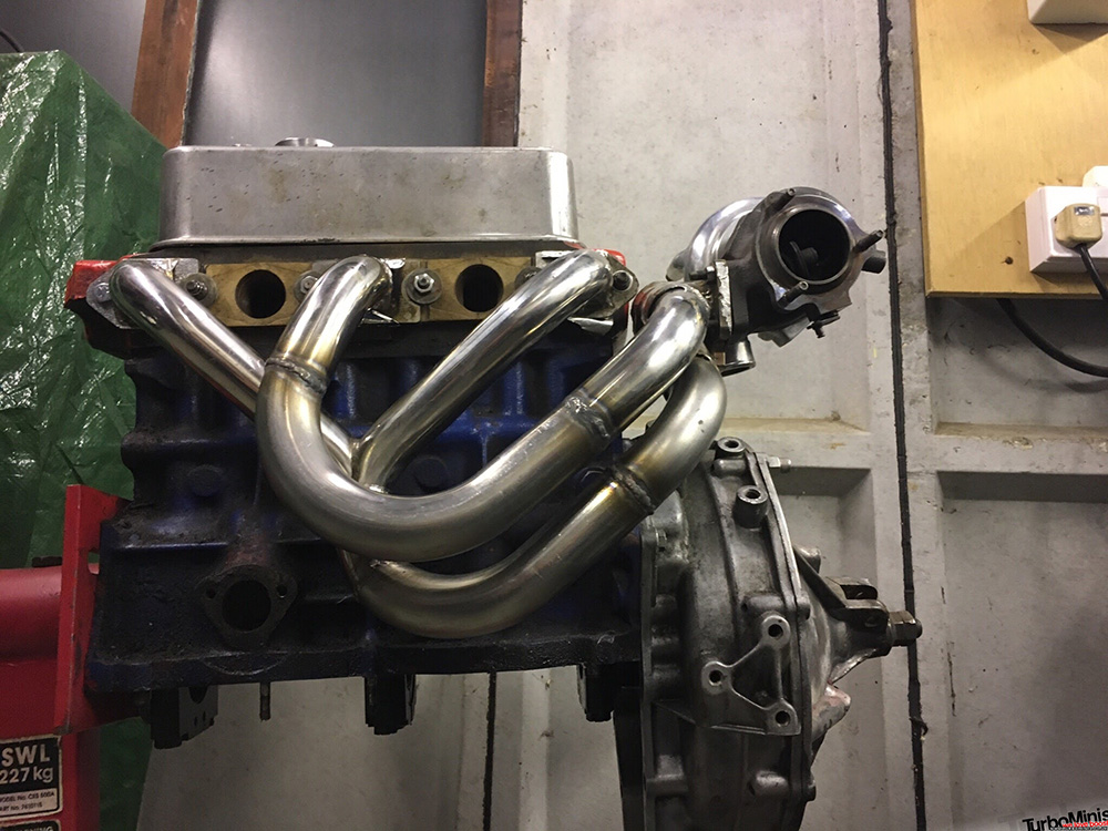

Looks awesome. Im still working out if i want to go for sidemount or not. Engine is still out of the car, need to get my cylinders done first, before i can continue..
Unless you have a lot of patience and are happy to make stuff, I’d not bother. Its been tricky to get everything to fit. Under the turbo, there’s the oil drain, water return, breather, engine steady, actuator and support bracket. I’ve not had a load of spare time (because kids) and have thought about going back to having the turbo behind the engine many times. It’s still a consideration now as the car is harder to work on than before.

The turbo behind the engine is more easy but less accessable when needed. I guess the turbo can be mounted onto the engine with a bracket to keep it supported.?
It may be less accessible, but when do you need to actually get to it? Not very often, unless you’re doing something wrong. Also, you can just remove the oil/water feed/drains, down pipe and lift the whole lot out together to work on it elsewhere.
