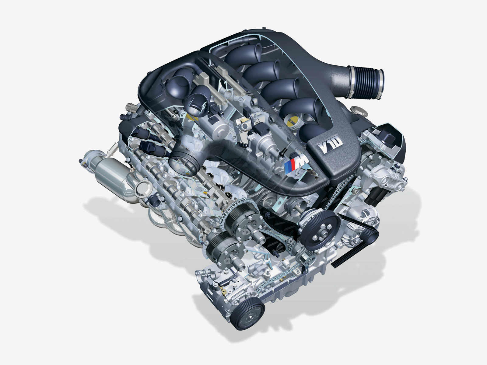

What I have found that (on a flowbench at least) is that there are some gains when you bend it downwards as it shifts the flow up in the port a bit so it could be beneficial.
for a 4th harmonic you could go down to 232mm, but 298mm would be a tad better.
5th and 6th harmonic are 188 and 158mm lower trq, after that the trq starts to suffer a lot but it is a lot easier to fit.
These values are based on pipemax for a 1310 race cammed 5 port a series, and tend to be quite near to optimum.
Keeping things straight does make it a lot more predictable but look at any modern engine bay and how they fold stuff in. For dry flow (not a wet manifold) you can get away with quite a bit .
One option could be the tuned runner to an airbox. Pretty much what every oem does as 3rd harmonic intakes are hard to package. Look at the V10 M5 . 90 degree snorkels in an airbox.
http://static.cargurus.com/images/site/200...-pic-37355.jpeg.
Edited by Sir Yun on 19th May, 2015.
