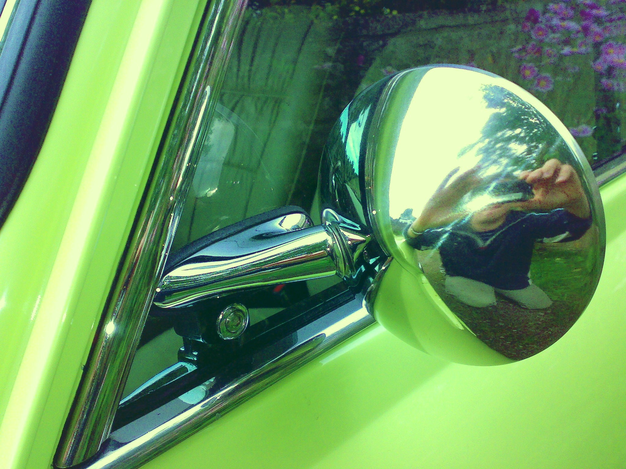

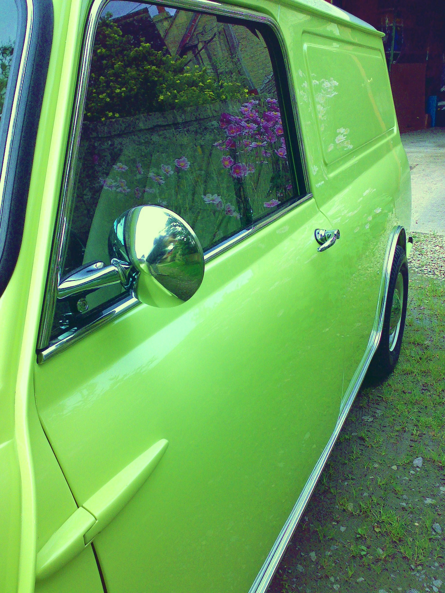

Im going to do a mk1 poly window conversion on mine and want to fit the mirrors as you have , can you tell me where they came from ?

I think I bought the mirrors from Europa, a really good car accessory mail order company. However, it was about 8 years ago so my memory is not as good as it was. Hopefully if you Google 'Europa' it should take you to the company.
Edit : just checked Steve.
The mirrors are still available from Europa at £16 each. This is the link:
https://www.europaspares.com/MIRRORS/EXTERI...H316__1632.html
Ordinarily, they are fixed with one screw and a stub which locates in a hole. I ground the stub off in order to mount flat on the sliding glass window but used black Sikaflex 221 industrial adhesive to bond the rubber gasket and mirror to the glass. If you only use the one screwed hole, the mirror would rotate !
I'll load up a pick later of what the mirror looks like on the glass.
