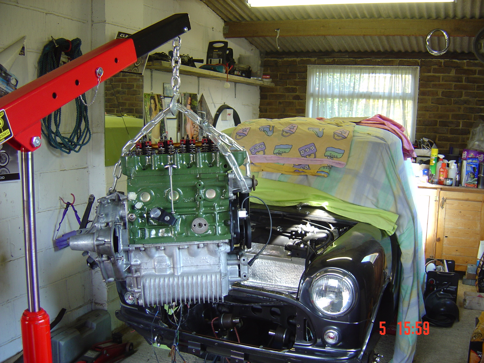

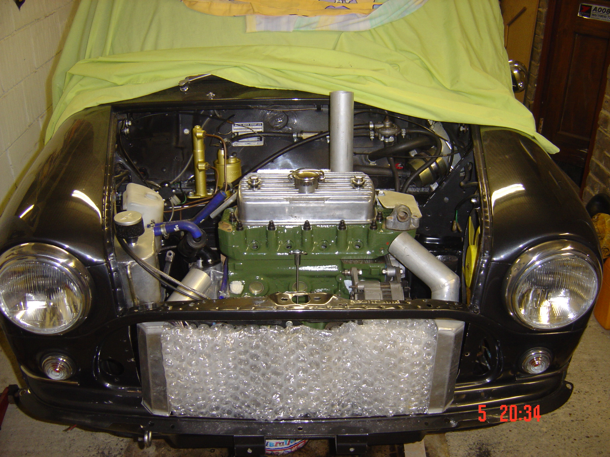

jon dinley
12 Posts
Member #: 7967
Green engines are the way to go, looks just like mine 8-)
Ofcourse I'm not actually using a bubble wrap intercooler, but you get the idea!
This has all been sorted now but the photos are still on my camera, I'll try and post a couple up tomorrow.
