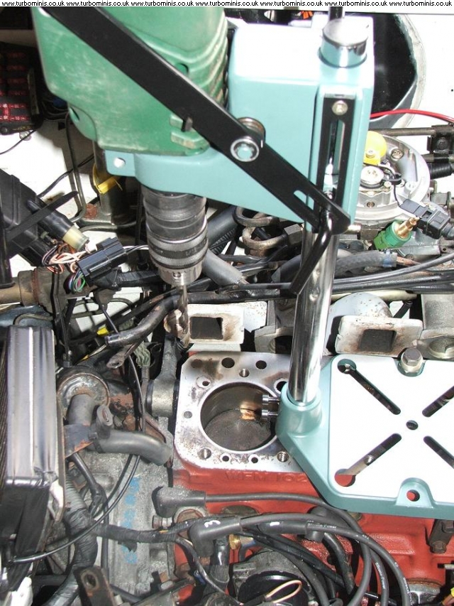

Just used a couple of magnets to collect the swarf, befor it got anywhere near the bores. These magnets obtained from the Ford MTX75 gearboxes and bloody strong.*wink*
Must admit i did feel a little nervous*tongue*

I had images of a crusty black&Decker electric drill being used.
Good use of what you have to hand, but I think I'd not have bothered myself?
LOL
Black and Decker. Bosch mate, nothing less.
Still, when I read that it made me think of that topic on MF with that child numpty, who thought you could mod the center main cap with an angle grinder to fit a steel strap. LMFAO!!!!
9323 Posts
HAHAHAHAHA thats great! good solution though
we made some guides up to fit in my head that held the drill, then used the depth gauge on it to make sure my mate didnt go through too much (i was too scared to do it myself)

Anyone ever drilled em for bigger studs ?? Or felt the need to ?

dont the maestro boys do this??
(stevie-when i met you at avon park back around may, i was running up the strip next to you, on that run i blew the head gasket out of the 11stud on the flywheel side)(thats a pointless story, but kind of relevent)
I think Pete aka mini1071s is doing that on one of his mad engine builds.
I had to drill my head first too. I drilled the head the tapping size of the block first then used it as a guide.
All on a 998 block too.
It 100% solved the problem of head gasket failures and was worth the effort
i would be inclined to agree! with the two extra studs in my humble opinion

I have just had mine done at morspeed was too nervous to do it myself! I think its just a bit of extra protection!

I did mine myself and havn't had any problems-still using std head studs.
The maestro boys use larger studs as they can't get decent ones in maestro size.

I have always drilled them with hand tools and not with such sophisticated equipment *smiley* Most of the time the studs are even at right angle to the block ... !
