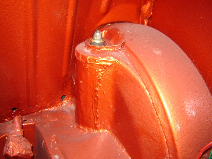

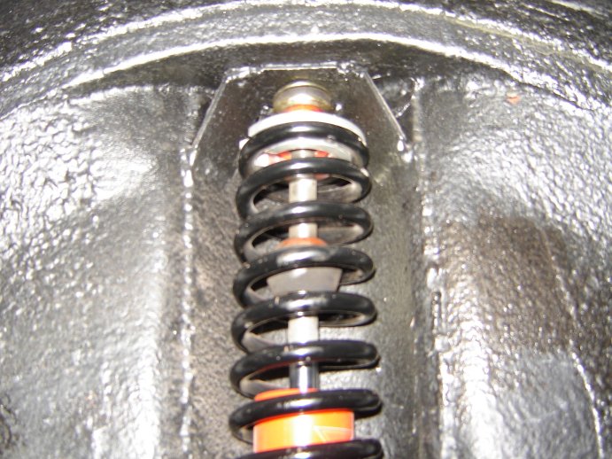

Someone here recently asked for pix of coil over mountings. I couldnt find the post but thought you'd like to see mine (?)
I'm no expert but I modded the arch with a deeper inner arch depression (pic1), welded support inside the mounting in the arch (pic1) and then extra support in the boot area to support the extra stress (pic2). I also 'ground out a very small piece of the lower rear subframe just to ensure there is nothing to chafe the spring.
The AVO coils fit a treat with 13x7s.
