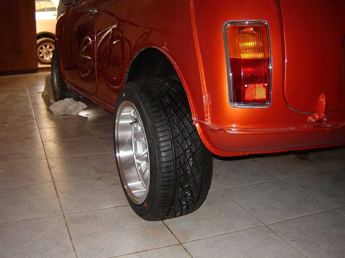

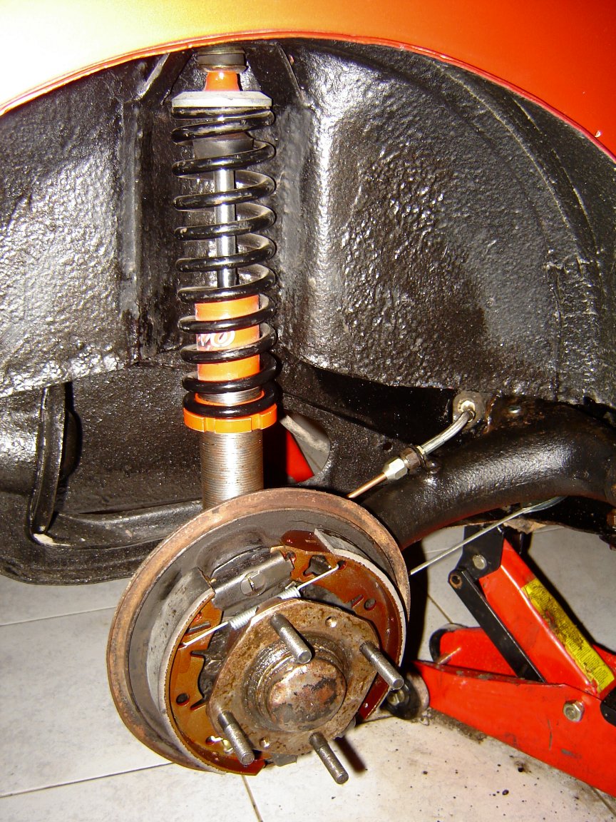

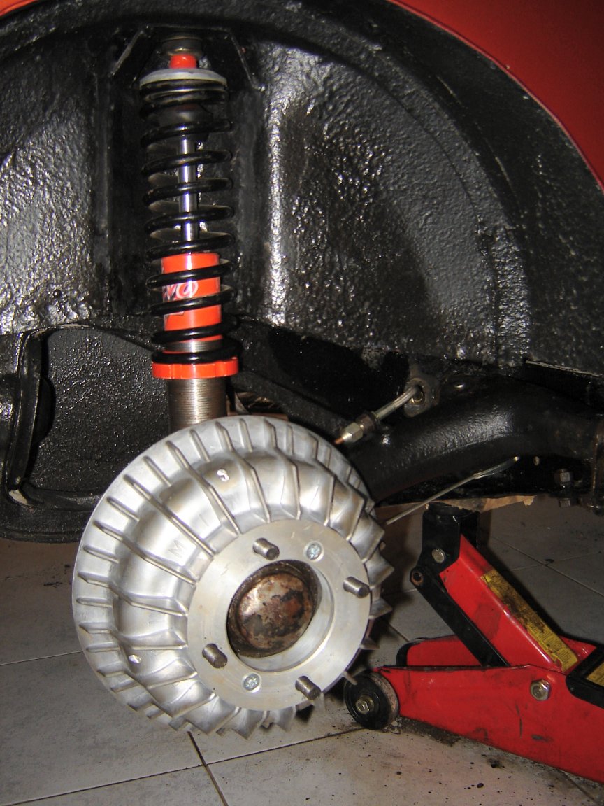

There has been a few posts on TM regarding the use of coilovers so I thought the pictures may help. Mine are AVO's, fitted all round, rear arches modified to suit (I didnt want to fit the offset type). I also fitted new braided brake hoses, handbrake cables, radius arms and mini fins at the same time. Methinks I need some big arches!!

reddy ,,do you know what spring rate that is ?

Thanks for the comments on the colour Rich. The spring rates are 125lb on adjustable ride height. I'm using a subframe and the car is built for fast road use with no rear seats and a rear cage fitted. Next job is rebuild the gearbox and then on to fit the head modded by Benross - lovely jubbly!!
