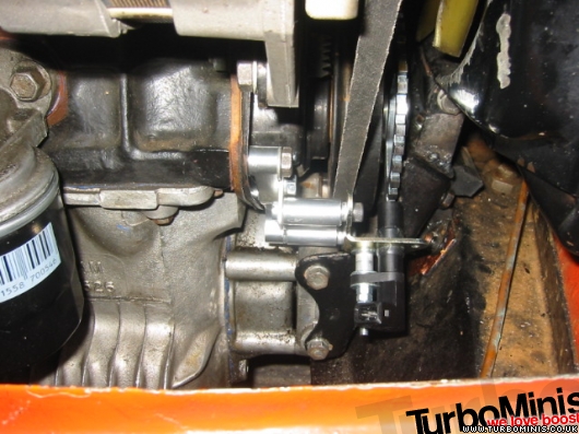

unlike my usual mode.. no flames, no fire, no: that is odd, that bit is normally not in the way..

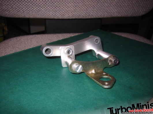

edit: well the SC trigger would foul the V belt in this car (wtf!? this car was mass produced..i have seen it fit* other peoples cars.
*(But in any case i now noticed in pictures on the autosportlabs site that various installs needed fettling/filing. it will probably only clear (just) with a short and new belt or a denso alternator which will be closer to the block but in my instaal even with the alternator fully in the clerance would have been about 1mm which IMHO is not enough to keep it from touching).

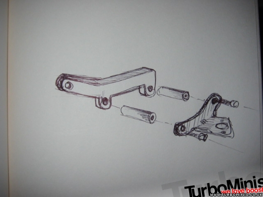

i'd say include a proper piece of alloy instead of what i fitted (everybody needs washers to get the sensor to line up with the wheel anyway) , and redesign the bracket for the next production run (johnk ?).

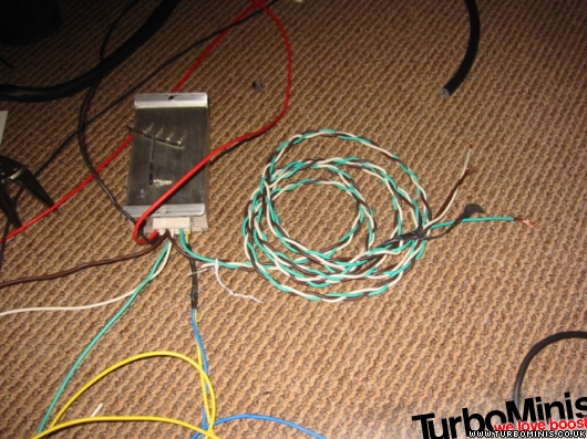

have to wire it up properly now.
