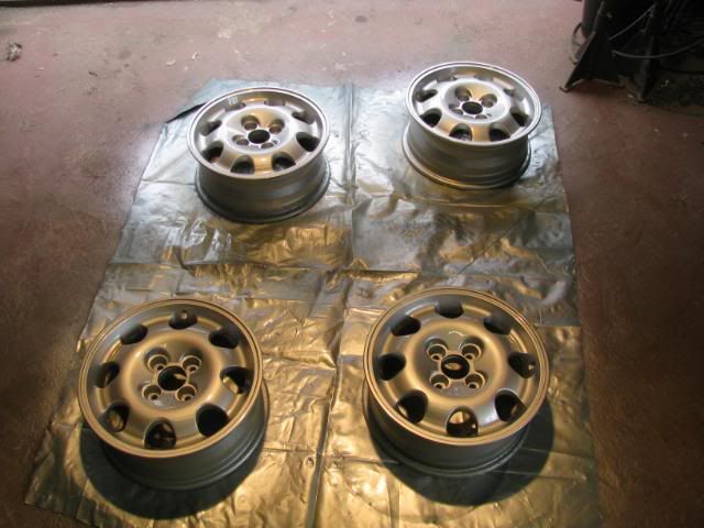

Well here are my painted wheels, in the end I let the base go touch dry and then lacquered them. They are for my Peu**ot sorry
15th Apr, 2009 at 10:40:00am
They look smashing, but you need a bigger tarpaulin! Fastest 998 mini in the world? 13.05 1/4 mile 106mph
Forum Mod ![]() 5933 Posts Member #: 784 9 times Avon Park Class C winner Milton Keynes |
15th Apr, 2009 at 10:41:04am
They look good Tom.

A tip for next time Tom, get them higher and you wont blow dust around so much

Did you use etch primer on the ali? Geoff |
Site Admin ![]() 15302 Posts Member #: 337 Fearless Tom Fenton, Avon Park 2007 & 2008 class D winner & TM legend. |
15th Apr, 2009 at 12:47:16pm
Yes I did
