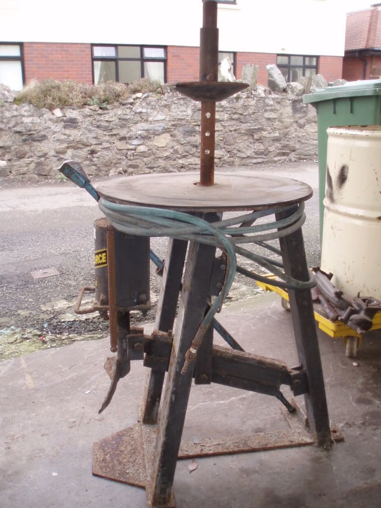

Found this forsale.
http://www.pistonheads.com/sales/1507832.htm

i use one of those at work, it works fine on tractor wheels/tyres

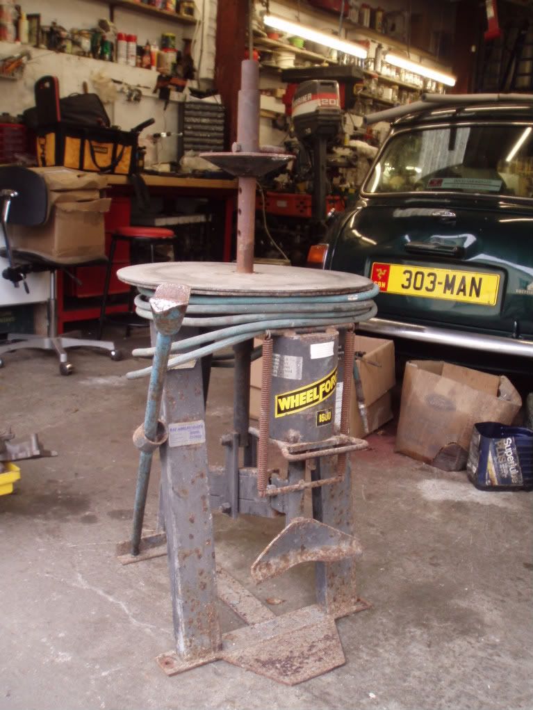

well, ive inherited it:
this week ill buy some rim soap (and probably a new tyre spoon), and next weekend ill be taking the tyres off the british open classic's rims to give them a blasting and lick of paint getting it ready to sell
Ill report back, and if it does the job well enough, might even give it a lick of paint, lol
Well, had a go at taking a tyre off the spare today
to minimise risk to the outside rim, i gave it a go levering the bead over the inside, but with the heavy duty steel tyre lever i got with the machine there was little chance of getting it over without seriously grazing the rim at some point, even using rim protectors, so just ordered one of these
http://cgi.ebay.co.uk/ws/eBayISAPI.dll?Vie...e=STRK:MEWNX:IT
should make it a more stress free operation, will leave the rest till this arrives
