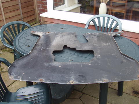

Hmmm - I always wondered what the point is with the ERA's cowlling on the front subframe? To force more air through the rad?
[X] nail here for new monitor
this is off a marcos
1380rich
484 Posts
Member #: 4755
warwickshire
cheers brett *happy* perfect
Brett, you wouldn't have any more pictures of this would you? Ideally fitted!
no i dont sorry

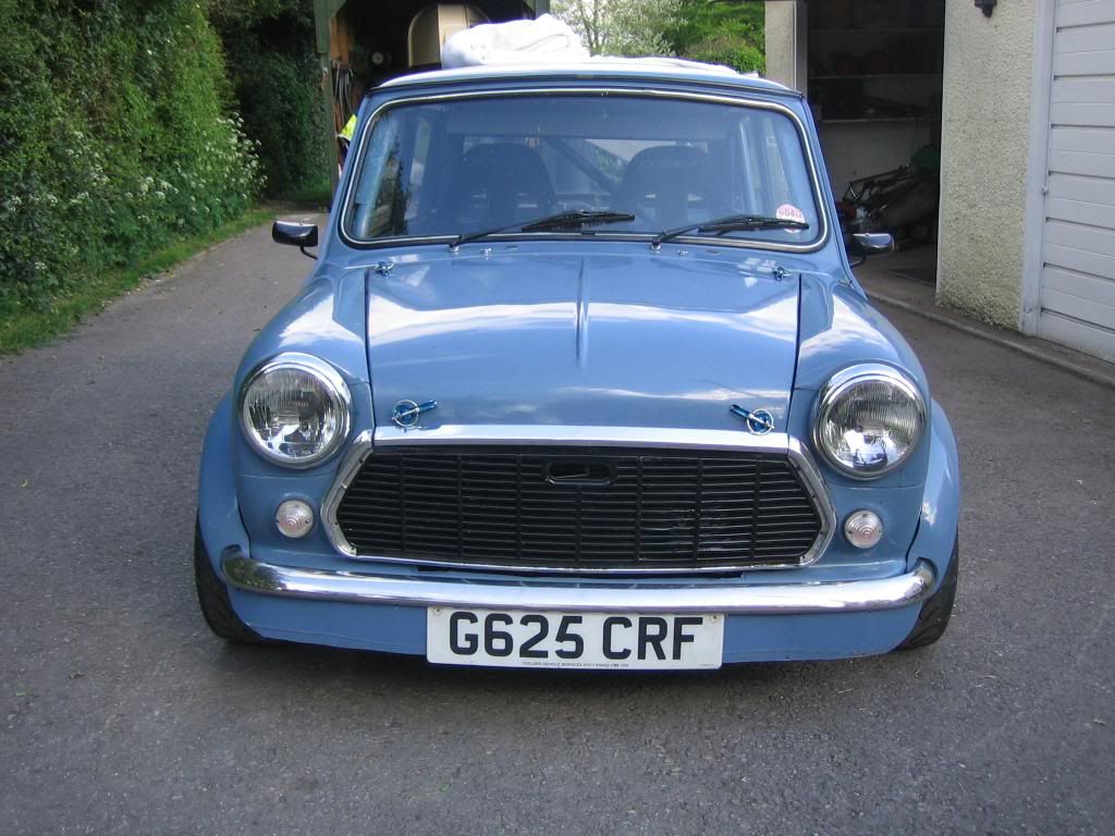

I've been out playing and pretty much closed the grille off where there are no vents/rads/ducts.
Will also panel in the subframe undersides front and rear when I can find a piece of ally big enough. Not gonna bother with anything else.
Edited by minimole23 on 7th Jun, 2013.
What I plan to do is ducted rad and ic kinda either side of the engine bay area and block off the rest of the air, try and channel ot out of the wheel arch/a pannel area. I would like to do a front air dam of sorts but dont want anything ott really.
