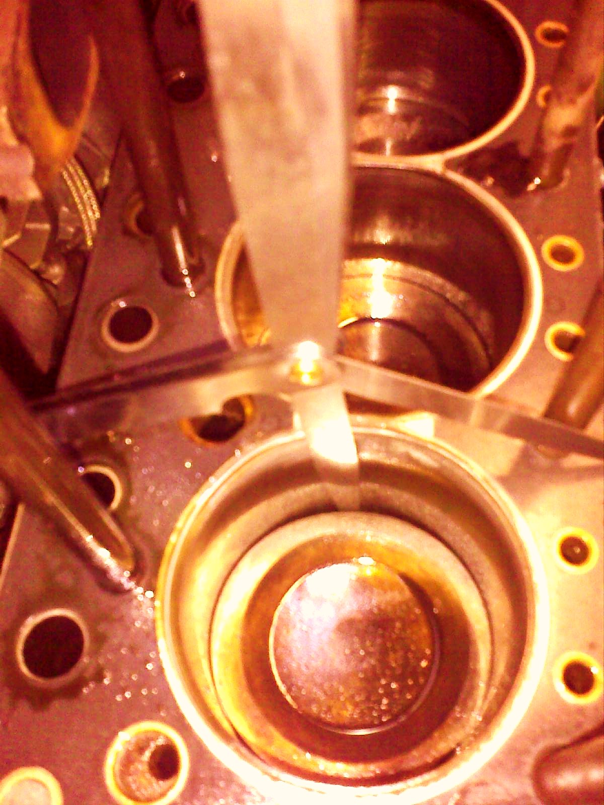

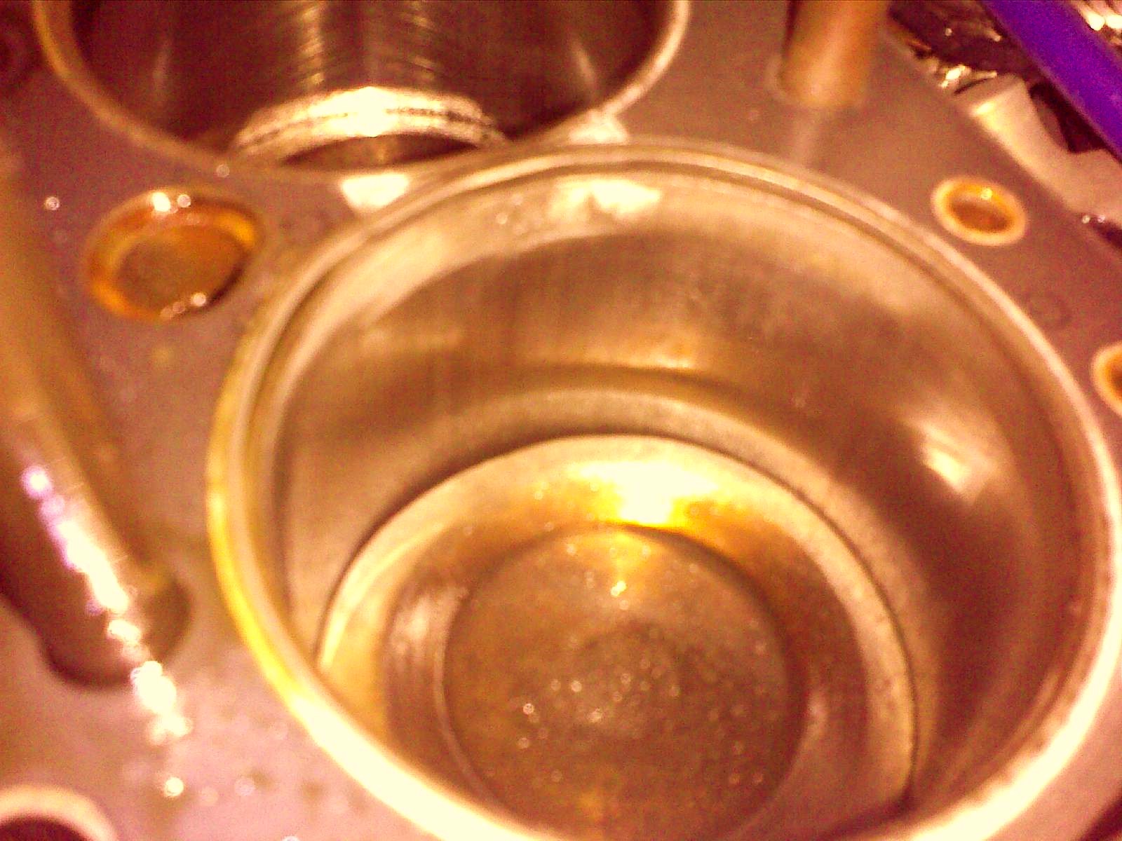

The pics attached show about 1/3rd of the circumference of the piston has melted away and deposited itself above the ring land on the non contact area of the cylinder wall in the squish area between No 3 & No 4 cylinders and there are signs of ali all around the chamber wall in way of the inlet valve in No 4 combustion chamber - this looks and feels like it's been 'metal sprayed' and the texture is like fine sand paper to the touch.
In one of the shots shots, I've inserted some feeler gauges between the piston and the cylinder wall - the gap is about 0.030in and by looking directly above, I can see the inside surface of the top piston ring ! It's fecked.
Worryingly, two of the other cylinders/pistons also show very large clearances but there is defo no sign of det on these which is strange.

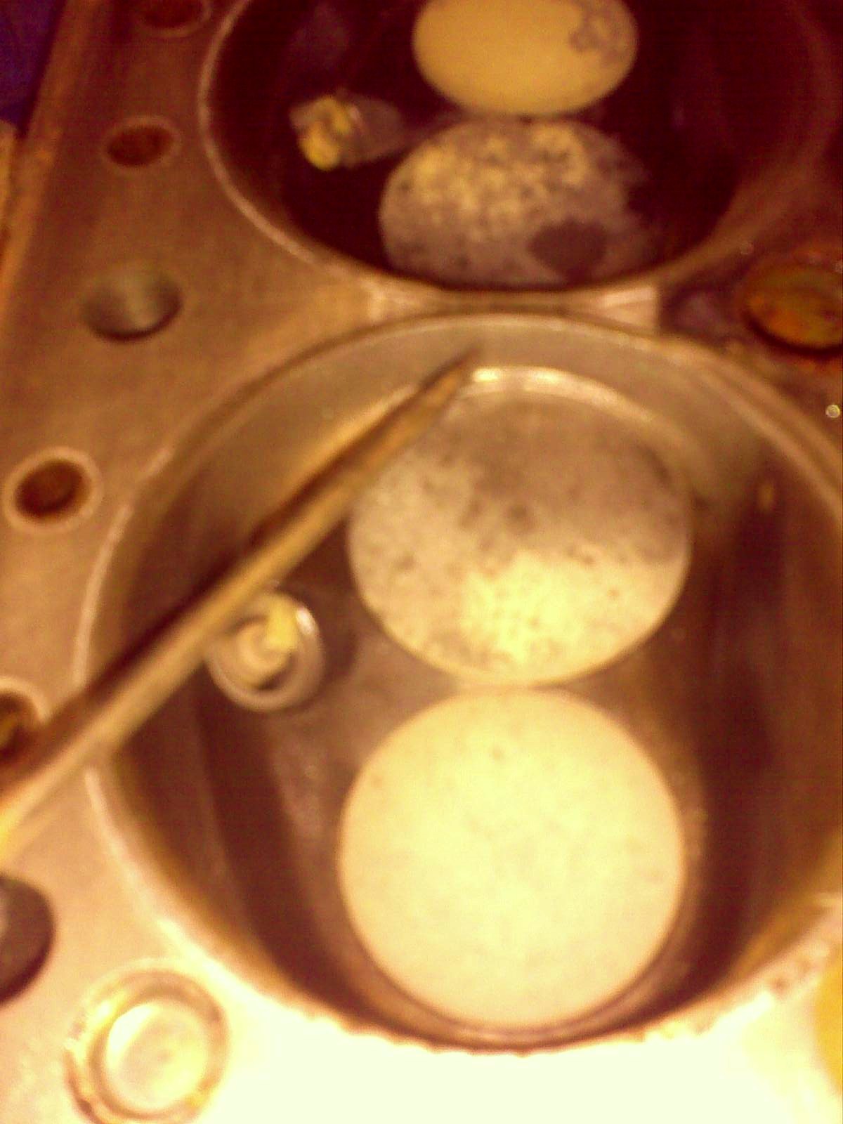

And a pic of the No 4 combustion chamber showing the grey 'metal spray' of the ali from the piston which has adhered to the chamber wall ........

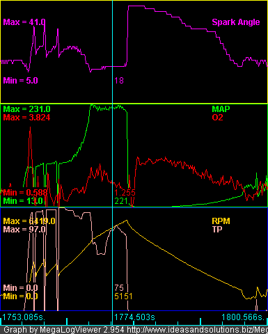

is that 1.255 lambda and 221 mp on the 2nd graph richard?if so that could just be the cause of it all.in fact if you look about 3mm to the left ,it gets even leaner .
lots of sympathy chap , i was really hoping to be wrong when you asked me what wrong and i said ring lands , hopefully the other pistons are fine and another one for no4 .
im using the cast omegas ,and have had no probs.
did you burrette the head and piston for the cr ?
id have thought that 8.4:1 and 18 degrees and 17 psi should have worked ,but not if thats as lean as it looks .
hmm , looking at the lambda ,am i reading it wrongly , it seems to show 1.255 ...18.44:1 afr ,and seems a lot leaner a bit earlier ,id have thought that was too lean to run ,is that an accurate afr richard ?if so id suspect it was detonating a lot earlier in the run ,and just eating away at the pistons .
also looks like a max boost of 231= 19.26 psi.
i think your right on the backing off a little has leaned it off ,is the lean off pipe on there ? any pressure diff from the plenum to the manifold can kick this into play a tiny bit sometimes .

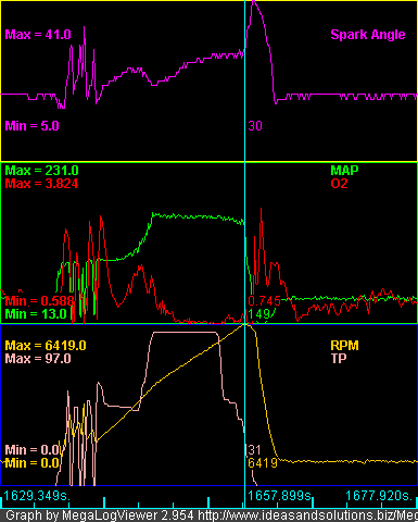

Looking at the plots, I agree with Robert, there are some very lean parts during the acceleration with additional leaning of as the throttle is partly closed.
I don't quite understand the first plot though, it seems to show it happening only at mid-RPM but it didn't happen when the throttle was part closed near peak RPM.
Having said that, The MegaLogViewer is very hard to read from a static photo so I may be reading it wrong....

Is that 1.255 lambda and 221 mp on the 2nd graph richard? If so that could just be the cause of it all. In fact if you look about 3mm to the left ,it gets even leaner.
Robert, it’s 1.255 volts, not AFR. The AEM cross ref says 1.25 v = 12.5 AFR and this was what was showing on the gauge. However, I agree, the LHS of the graph is leaner at around 13.6 AFR peak and I put this down to the throttle lift off which did recover the mix but you’re right, the damage was prob done by then. On the basis of approx 1 psi = 7 Kpa, 221 KPa = 17.3 psi.

… also looks like a max boost of 231= 19.26 psi.
Momentary peak on overshoot Robert which I shall address when I re-optimise the response settings on the boost controller. Still, I was pleased with the boost stability on both runs.

Rod, I think there have been numerous occasions where the part throttle area of my fuelling is crock and on the road, I have massaged it by consciously closing and then rapidly reapplying WOT to clear it which is a fudge, I know and realise that now.
As the RPM and MAP curves show a steady progressive rate with no blips, I think the advance at the part throttle area you’re referring to has exacerbated the fuelling issue but I’ll need to look at that again when it’s sorted.

Sprox.
Great shot mate, makes mine look like a walk in the park to fix.
I guess it's a fair question but with the valve cutouts for the 16v bimmer conversion, the work on the piston crown leaves a shit load of sharp thin edges in the flame front.
In their own right, aren't these a source of detonation ?
Is there scope to smooth these out without affecting CR or ring land ?
Richard.
