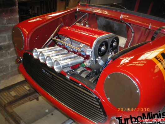

A hillclimb engine with the worlds first big valve K head on a Mini from SC. The engine had its first outing last weekend at Wiscombe and finished 1st/2nd in class on the Sunday and 1st in class on the Sat straight out of the box it posted a time 0.5sec quicker than the 09 K Sprint engines best. Father and some both agree they need to adapt to all the extra power they have now - result!

jetblick - I ran a 163hp K in one of my cars on the road, previous to this was a very well developed 1380 running a genuine 135hp. The K would tick over at 1000rpm, pull top gear from 1400rpm, once above 4000rpm theres not a lot would touch it - certainly not a 1380 5 port with a 300 deg cam!
This race engine was remarkably civilised and I'm sure could be run in a road car with no driveability problems.

Im sure its just my eyes playing tricks, but those ram pipe look massive! Overall, are they the same length as the standard throttle including your ram pipes?

Matthew your eyes do not deceive you for this engine spec it needs long inlet and very different cam timing to work. If you overlay the graph with a regular sprint motor they are pretty identical to 5500rpm then the valver goes for it with style!
I'll post a pic up soon of the engine in the car

John, looking at the graph i appears that the motor made 150 hp @7k, is this right,

Carl, just under 147 ish

Thats the length of intake optimum for this spec - torque generator!

Nice ! What's the increase in size over the standard valves ?
