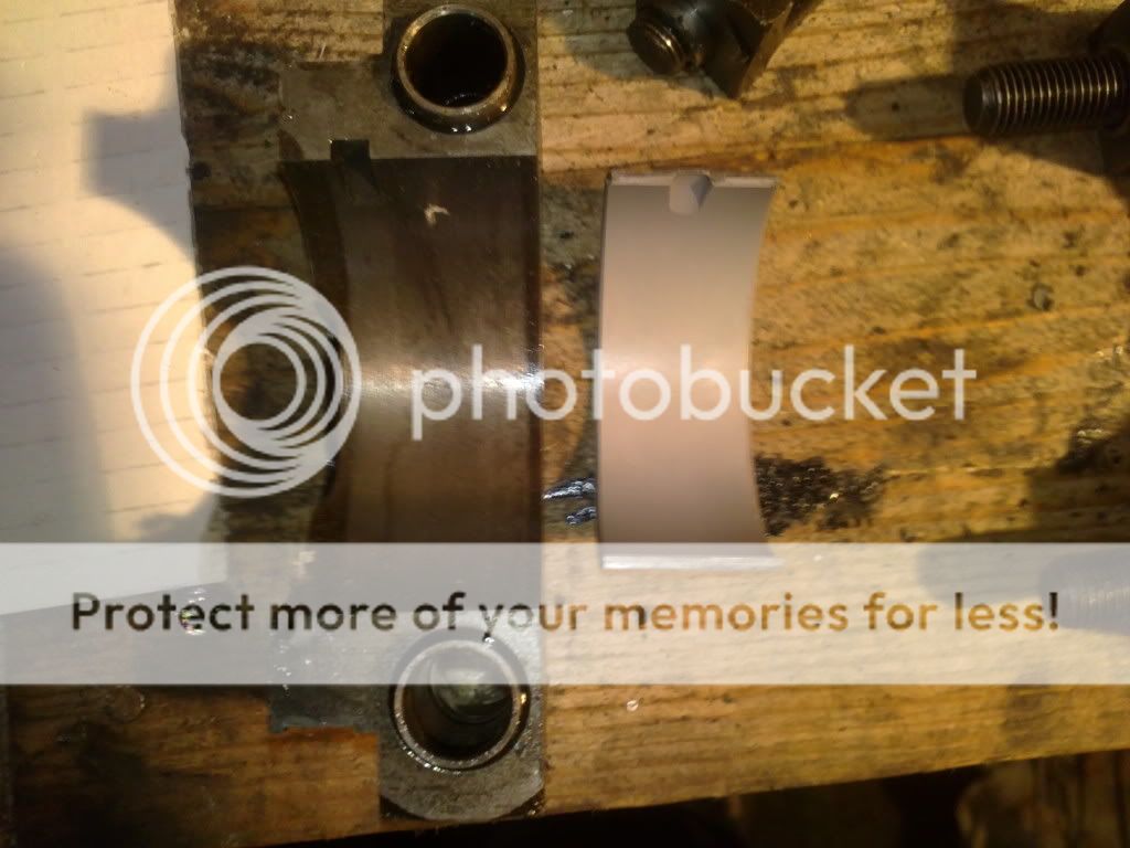

what bearings do i need for these turbo caps? as you can see the notch is in the wrong place

just notch a slot in the centre for the bearing tang.

ok il do that. still doesent help that minispares sent me +10 when i orderd standard!
i think a -10thou might be a little tight on a 0/0 crank :)
Fit proper A bearings, that's what you do.

I always get mixed up.
Do the later ones have the central tang and the earlier A ones have the offset tang?
Also are the A ones grooved at the bottoms?
A ones are grooved at the bottom as all other proper engines. These sport the offset tang on all six bearings.

i have another a+ set that are offset tang its just my turbo 1s that are central a+
Just making sure but you aren't mixing and matching caps with blocks are you? You should always keep the caps with the block they were made for.

no im not, im using all the originals
Just checking *smiley*
My early A plus block also uses the "so called" A bearings with the oil groove and offset tang.
I think it's a misconception that all A plus blocks use the un-grooved bearing, my caps are all original to the block and take the earlier shells.

so are a and a+ mains the same size then? Ive orderd some metro turbo shells
Yes. early A+ blocks had the old type of bearing.
After my main bearing failure in 2009, I opened out the center bearing oil gallery and fitted the groove/ groove bearings, since the crank fitted is not cross drilled, and will not be rev'ed much beyond 7500rpm.
