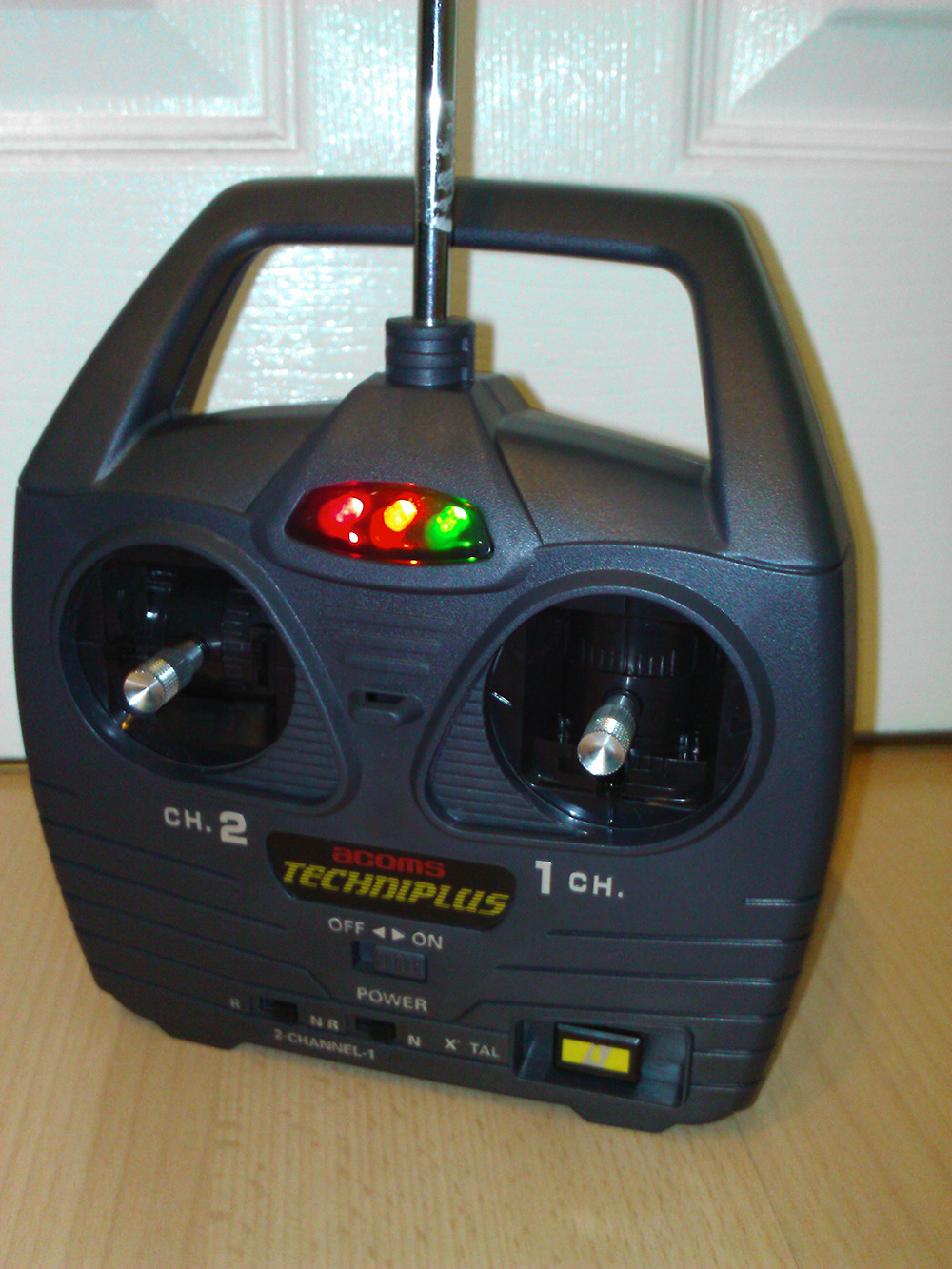

Need a new transmitter cos mine keep cutting out at full forward throttle, bit annoying.

You need a transmitter and receiver - 2 channel 27mhz, a pair of crystals, a servo, an electronic speed controller, battery and charger, a motor and some double sided tape or Velcro, must be strong though. And then the part of linkage to connect the steering to the servo, and a servo horn. You may need an additional battery holder for the receiver dependant on what esc you get, i just connected mine to the esc battery wiring, so its simply connect the battery to turn it on.
Oh and you can pick up some Acoms radio gear quite cheap on ebay now, either Acoms or Futaba I've ever used.

Haha, the mini shell is roughly 215mm from wheel centre to wheel centre. Just been out and bought a new transmitter, aerial sleeve and a mount, some R clips and a switch for the radio gear, ill get a finished pic up after :)

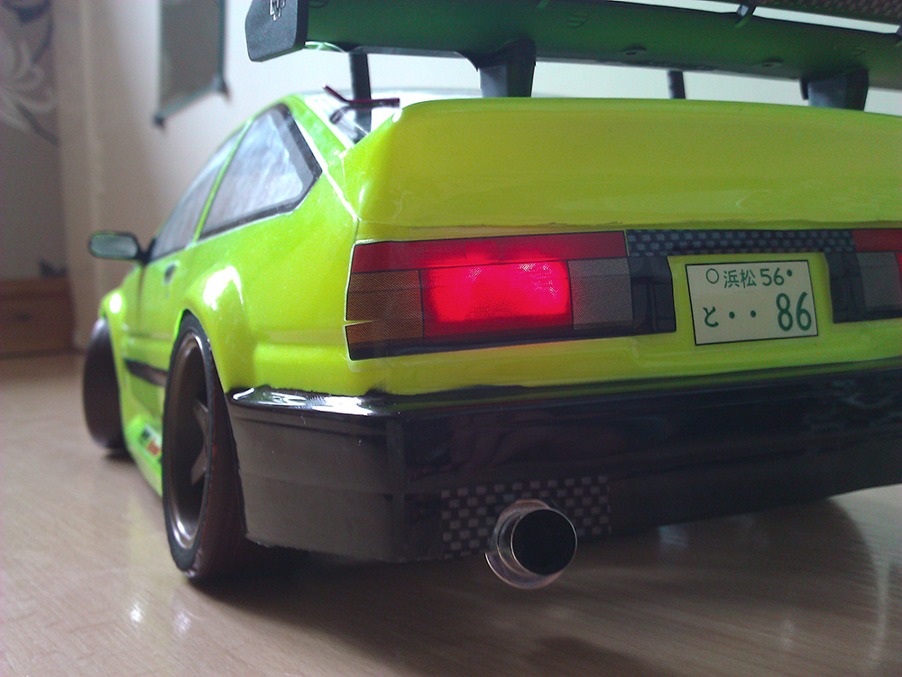

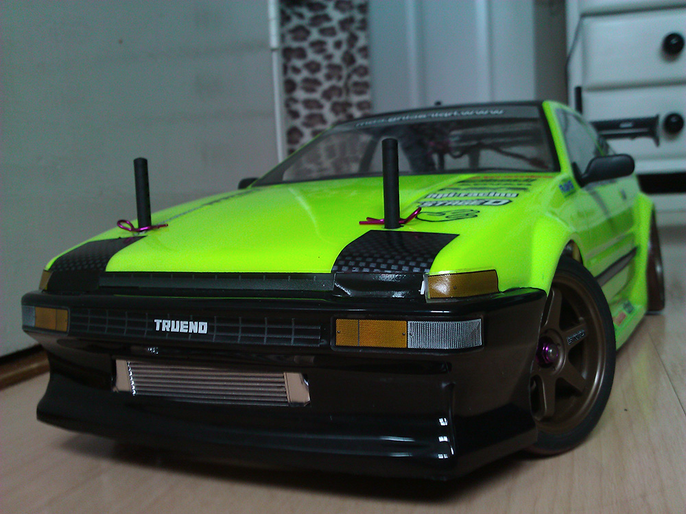

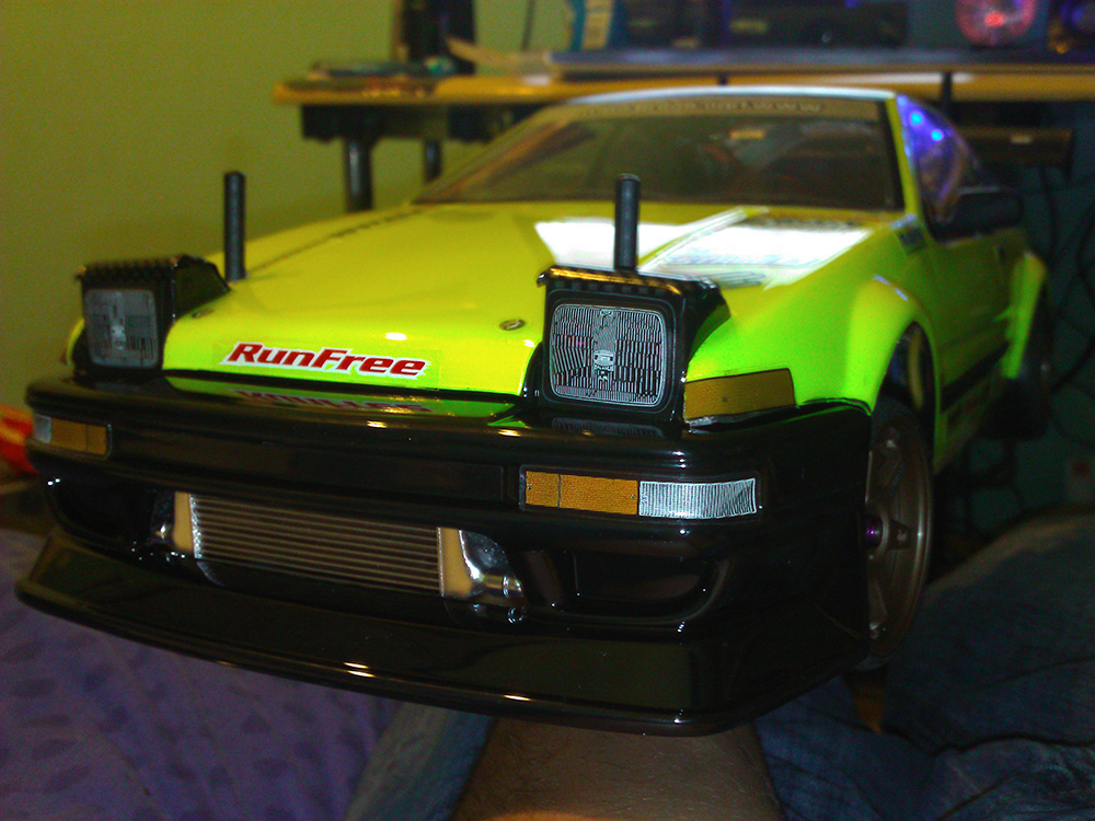

I now have my one of these sorted! Found a 550 motor going spare in a old car. New esc, 7.2v battery and some cheap radio gear. Goes really well too much throttle and it spins, forgot how much fun Rc cars are!
I bought an old yokomo 4wd car off a mate, fixed it up and bought a new shell for it. Putting headlights in soon and have working stop/tail lights *happy*
Plan is to have a go at r/c drifting.
