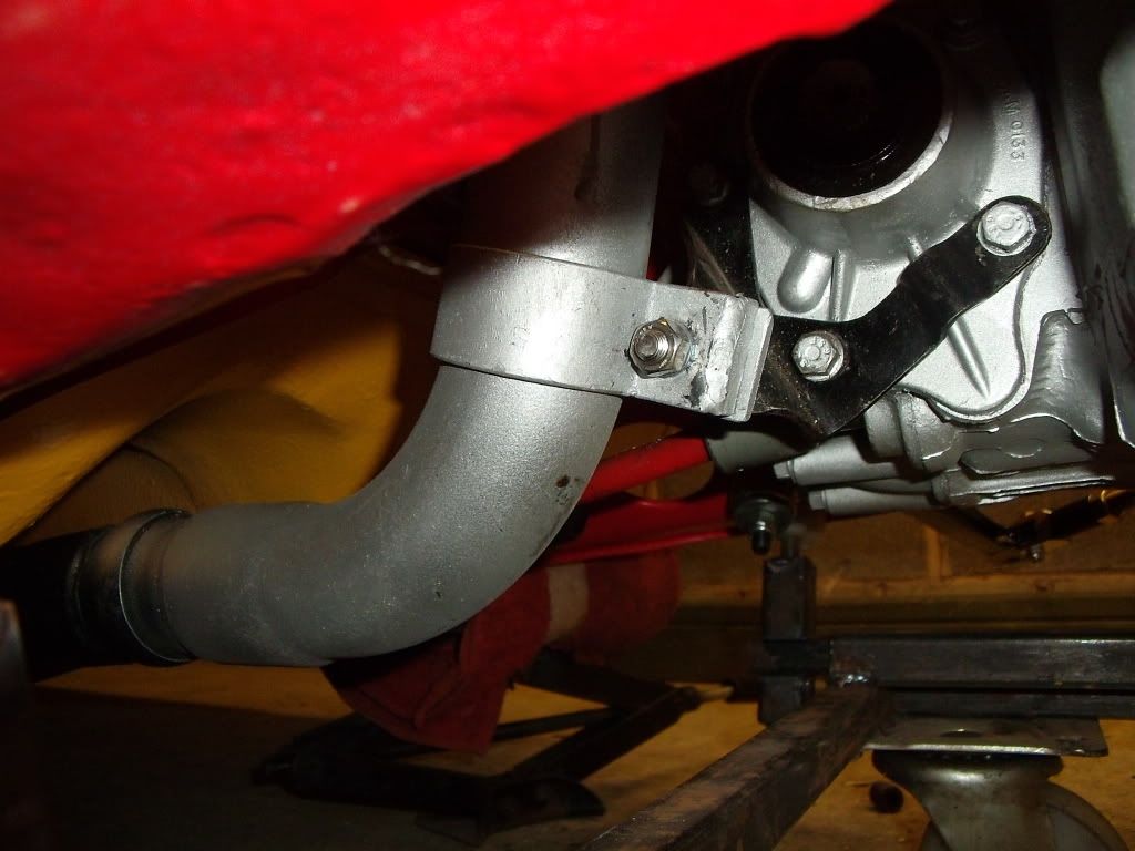

I mounted mine here...
Edited by matty on 23rd Dec, 2011.
This is where mine is mate hope it helps.
simon

There are two types Ive been told, Wide band and Narrow band, mines a wide band and should not be to near the heat, yours is somthing like.. Will wait a bit to see if there are any other Ideas.. Thanks guys.. Alan

Mine is a wideband and has been fine. But there shouldn't be any problems mounting it where Simon has.

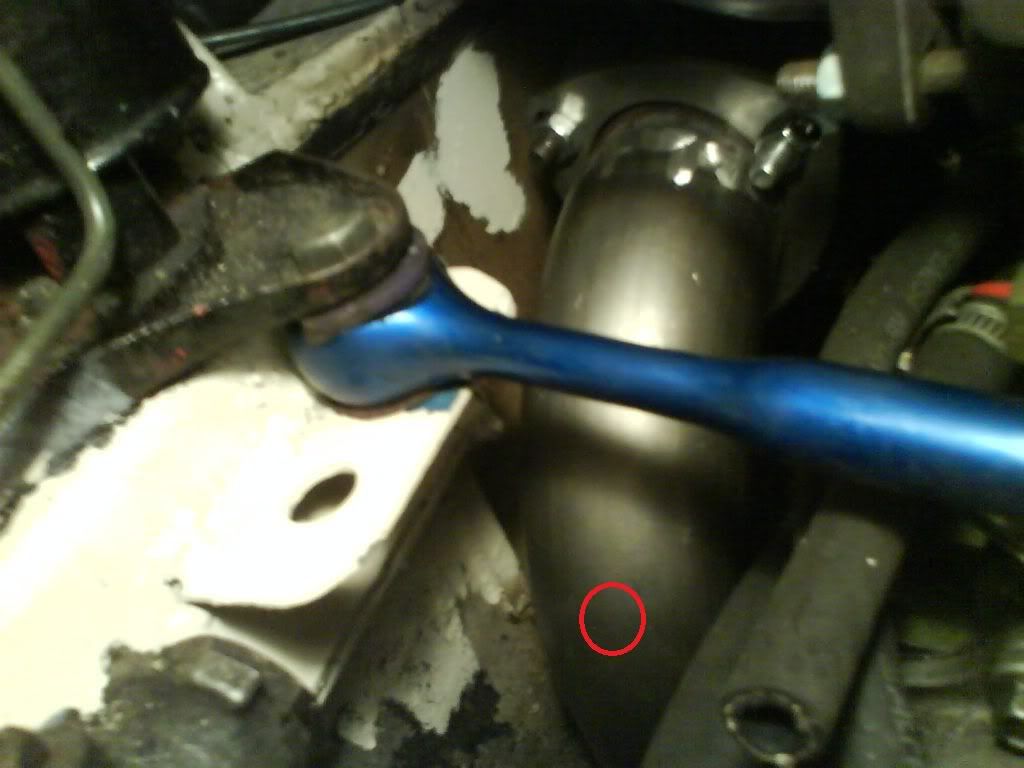

This is the view from the top, not much room there for access..
I think the best place for mine is where Simon has put his
and It’s before the flexi joint that Joe C brought to my attention..
