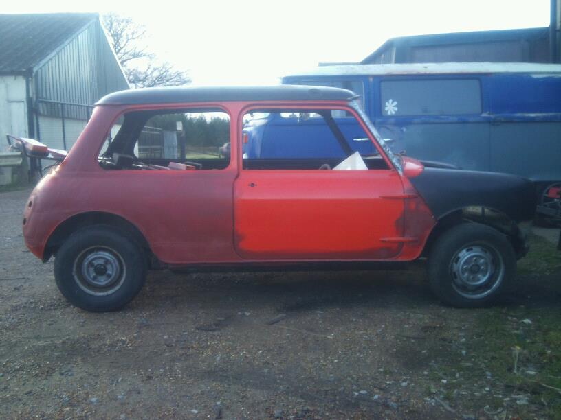

I was wondering if anyone had any pictures of a de-seamed or smoothed or even both minis

Thats exactly what i was looking for and its a clubman BONUS!
What did you use to de seam it?
still has the roof gutter.,.

That looks great *happy* how did you do it?
Alex
that clubby looks very nice james!!
Alex, its had 78mm cut out of the body, then deseamed,
