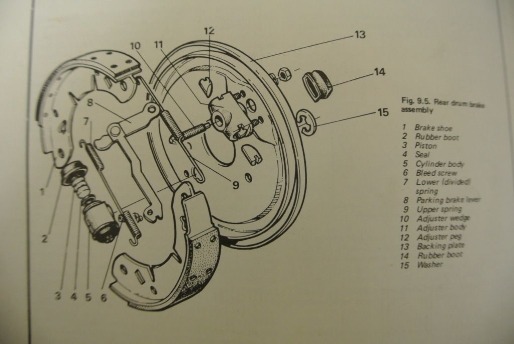

Will try to get a picture for you Andy
Edited by nala56 on 9th Aug, 2012.

nala56
825 Posts
Member #: 9661
Sheffield South Yorkshire GB.
Hope this helps, Andy..

Thanks Alan, that confirms I have everything fitted properly in the drum.
