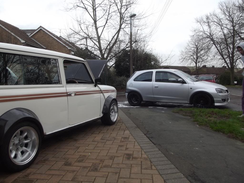

What colour is this mate, as I have a 71' clubby estate and going to turbo the car. Just wanted to find out is this Old English White
charlieb150
517 Posts
Member #: 9931
brighton
kappa to be honest i have no idea lol i painted the engine bay ford frozen white but the rest of the car is off white im not sure how do i find out
