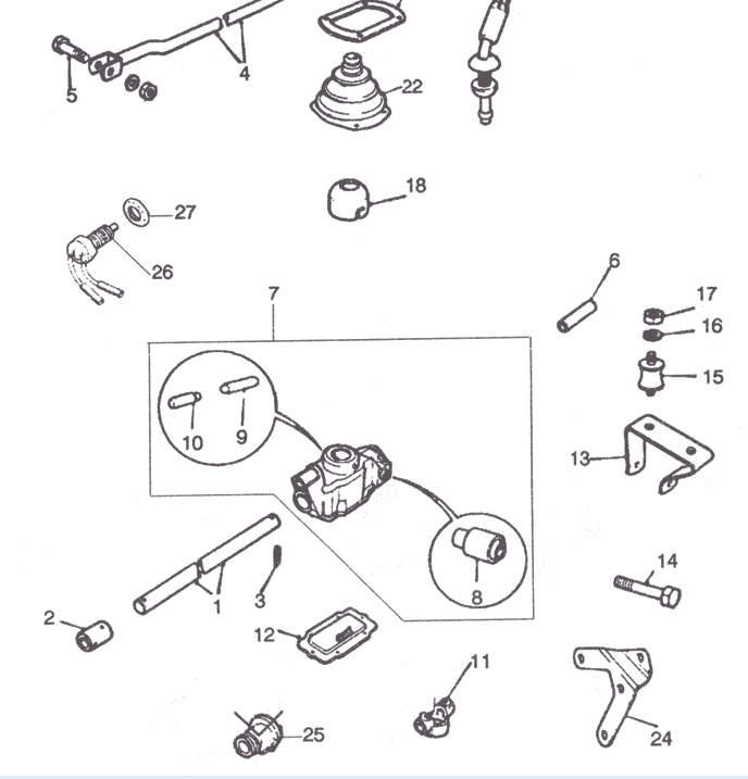

Alan - going on the instructions with mine, you have yours on back to front.

shows it being right on this from mini spares Andy..
Main Build
Upgrade to Turbo
Slide the bias barrel onto the rod, spring facing the back of the car.

Yes your right Mate, not had instructions for a long time for mine, had the dam thing for 2 years now been fitted
wrong all that time, should have known not to doubt you, It does look as though its right looking at that
drawing dont you think?..

Indeed. It probably make fook all difference either...

It makes no difference which way round it is. It is more important to get it in the right position on the shaft. I had mine to far forward and could not get second gear as it clashed with the other rod.
