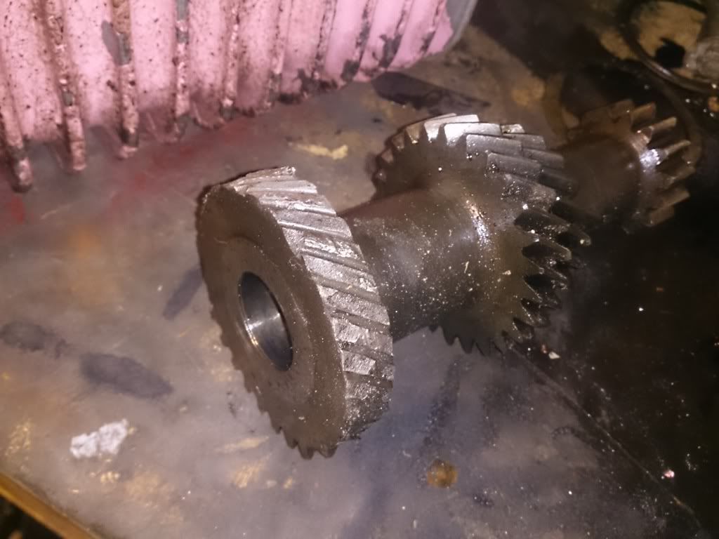

1st and 2nd gear on the layshaft total munched and stripped bearings seem good

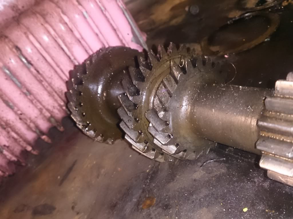

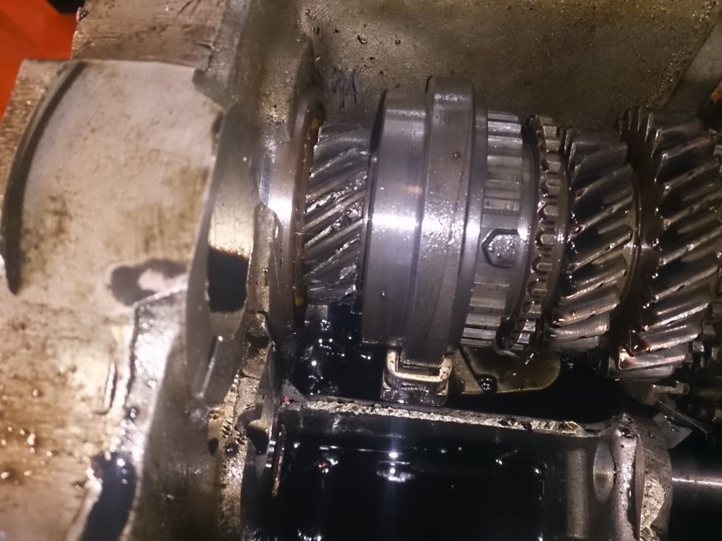

,,, heres a couple :) it all back running now had a spare box in the garage swapped the diff and centre pick up pipe over and finally put a longer final drive
2nd and the transfer has shat itself.

Had the bearings inside the laygear gone?
