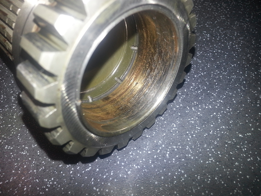

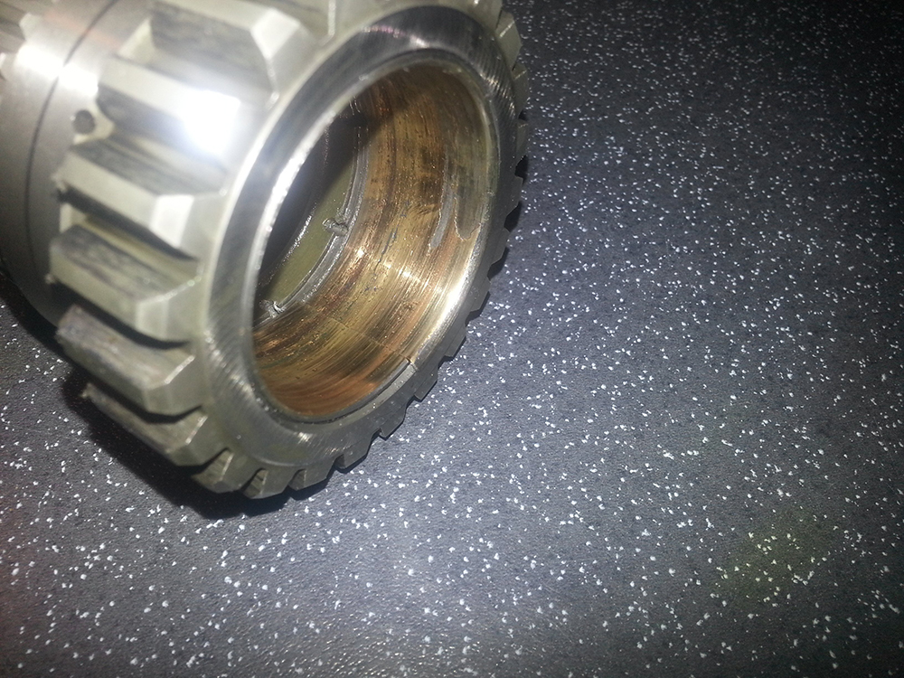

sooo, this came out my engine, crank is untouched luckily but this one is done
the grease i put on there when building came out like a powder :/
what do we think, i think a new one is in order but what about a floating bush?
http://www.swiftune.com/Product/414/primar...ating-bush.aspx
are they worth it or should i just get this re bushed / new one

has the bush cracked too, i got my mini sport drops rebushed after it spun the inner bush out causing me to have no clutch.
been fine since *smiley*

Fully floating bush highly recommended, fit them dry and your good to go. Not normally a fan of dry bushes personally but is a winner in regards to this.

As Tony says,
its both bushes that have gone
does anyone know if the swifty link is both bushes or does that show a 1275 and an 998?
also the minispares one says not for A+ ?
just the inner bush. you would still need a top hat.
6966 Posts
i think the MS ones have a small chamfer on thr inner and wont clear the fillet on late cranks, but 30 seconds in the lath sorts this out if you need it Brett

It says not for A+ but it never use to. I run the minispares bush in a helical A+ gear and have put ~150hp through it. Its apparently to do with the oil drain holes but then, that probably depends on which bush.

I had quite a few issues with the floating bush. As Carl says they need maching down slightly as they ride up the chamfer on the crank and seize themselves on.

Minisport also said they had machiuned mine slightly when new bushes where fitted.

cheers lads, i better get some ordered then
