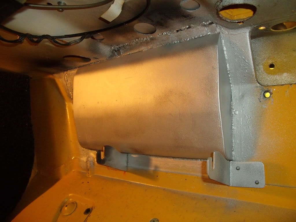

can you still run a standard mini heater with the bulkhead cut out for the turbo
Yes, you would just have to make up some new brackets i think (that's what I plan on doing)
Yeah you cut the section of the bulkhead out that the brackets are attachéd to...well one of them. Just cut the old bracket off, trim it and weld it back on, or make another bracket.

will have to make new brackets as the conversion was done by the previous owner

Posted this picture as a guide mate, this was when I was in the middle of moving my heater.

nice one cheers ill get onto it
