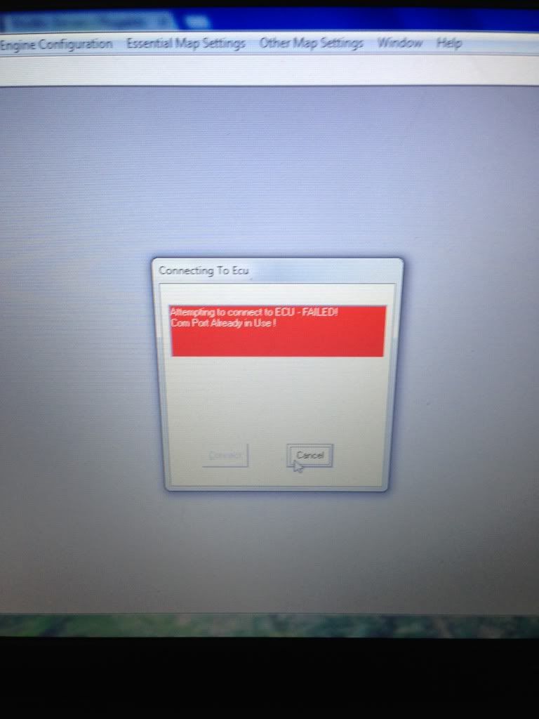

just got the latest drivers and now i got this:
+the odd 8020
any ideas of what could be tricking it/ or telling it its in use?

It's a very common problem, usually is down to the adaptor or it's drivers.

As above, the Prolific chipsets had a bad reputation (although I have a couple that work fine with the latest drivers).
The FTDI chipset is the one of choice for me, it's the standard chipset on the MS3 (to give it a USB connector as an alternative to the old DB9) and I use it on my IOx board (as a chip, not as a cable convertor) and it just works.
I also use a PMCIA convertor on my very old laptop (because it only has one USB port and I use that for a mini mouse), it also works fine.
First thing to check though is whether all the other settings for your virtual com port are correct, ie, baud rate, flow control etc. - the Windows defaults aren't usually what the ECU wants, not with an MS2 anyway.
