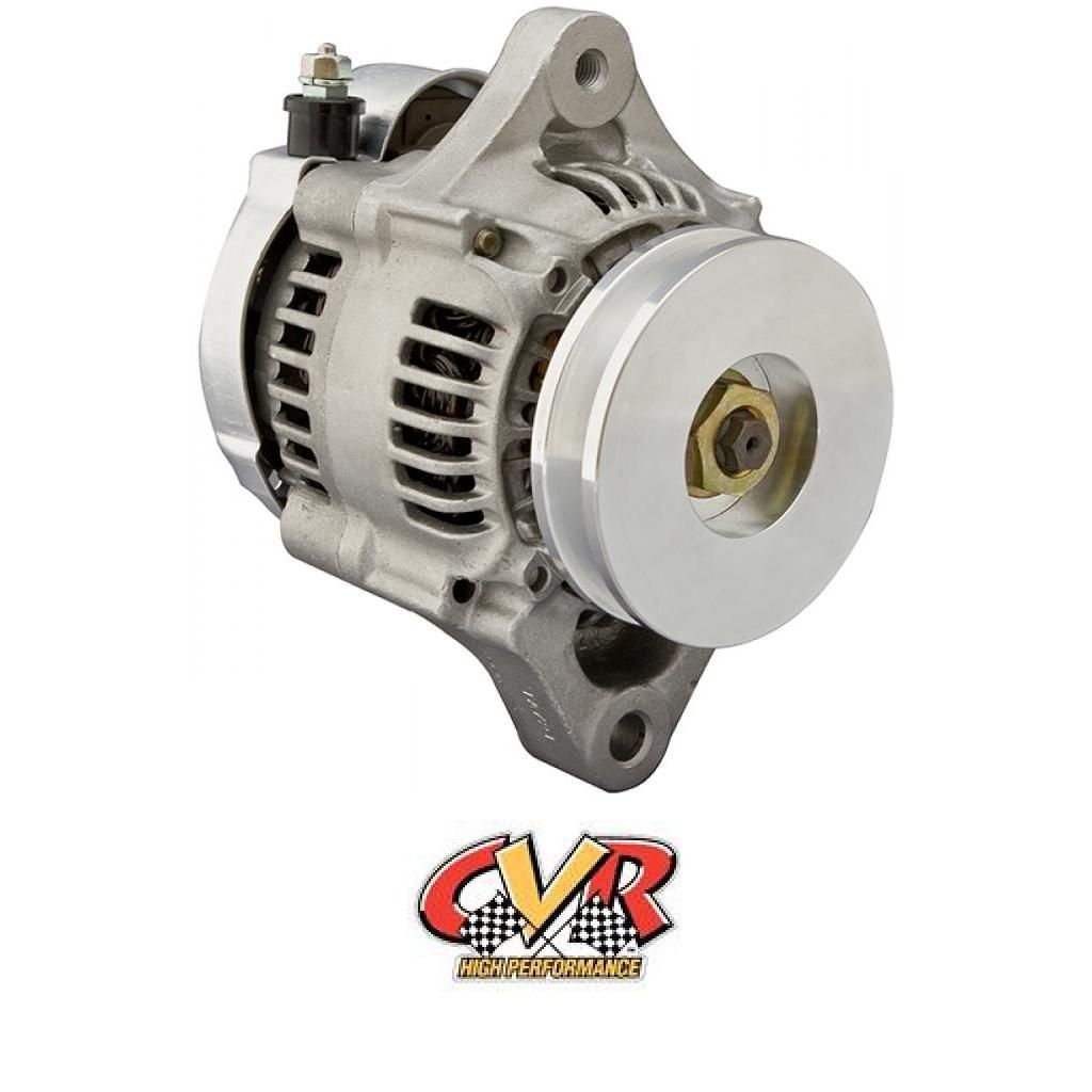

edit ive looked into this more.. fans and water pumps are max 38A =/ not leaving much for the ecu, injectors, coils, 2xwide bands and whatever else... thats said its not likely to see peak current all at once so do you think the battery can "buffer" out the difference?
i have found this and would like to know if it will run a street/track mini with ms3x EFI ,CNP ,cooling fans and davis crage electric pump it looks quite small when comparing the pic and measurements
50A supposedly
pulley, 3.15" dia
Mounting Bolt centres:5.53"
http://www.ebay.com.au/itm/CVR-PROPOWER-AL...=item27d66e9e9d

I'd probably go for something with a bit more amperage personally.

50 amp is plenty. Rarely are all electrical loads on at once & if they are the battery will act as a buffer. Cars draw less current than most think & those Nippondenso units will put out around 60 amp on a test bench. I am an Auto Electrician by trade & use these myself, I have had these fitted to my Mini's since my first mini in 1994. I have always used the one that fits to a Daihatsu Charade G100. Just make sure you have a good battery feed of 7mm cable or more to the starter solenoid battery cable.

I have a 70A alternator, albeit a mini one, and I'd recommend something like a pug 306 td battery. Just having your cars headlamps on draws 10a, the rough maximum current draw of a minis circuits is around 40a. Hence the 50a alternator. Now imagine adding what you are adding on top of that, a 50a alternator isn't going to cope unfortunately!
The factory injection minis used either 65 or 70 amp alternators. That's what you want to be aiming for.
