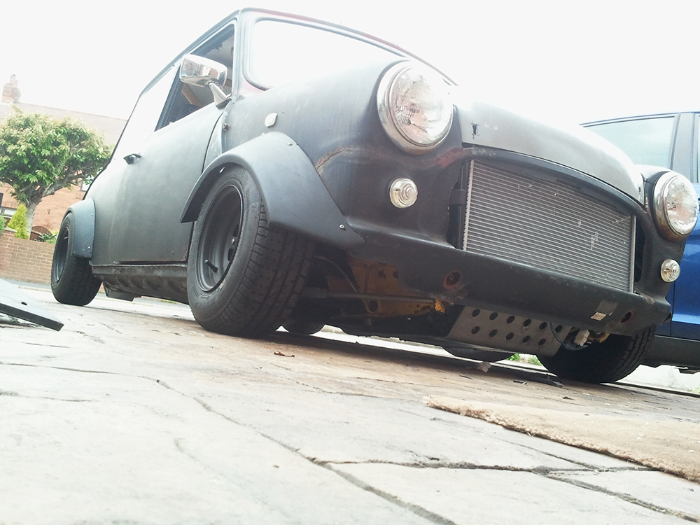

hey it works lol on the mini i never had a problem, i cant remember off the top of my head but it was not much more than 1 inch clearance, a narrow track and sort wheel base combined with tiny overhangs front and rear means getting over bumps is quite easy
bottom arms level with the road and straight drive shafts was a large part of the reason for the low height

loads of suspension travel mate, ride comfort was not bad imo, but helped alot by the 10ich wheels
handling was excellent, road legal and driven every week but not a daily drive

i have not heard many people say this and i guess your right, my mini as it stood in that pic was exactly the mini i drew nearly 20 years ago

i modified the hi-lows to allow it to go lower and trimmed the bump stops it has adjustable bottom arms and tie bars so the geometry could be altered
it has low hight upper front shock mounts aswell as low hight shock absorbers
arches and a panels trimmed much the same as fitting 13x7 wheels on
things like exhaust and gear selector housings are mounted higher in the chassis, tucked up into the tunnel
on the rear end it has a flat boot floor and no rear valance ( mainly for the diffuser) modified subframe, tubbed arches, modified boot floor where the radius arms sit modified radius arms aswell, its all modified for clearance to gain extra suspension movement,
