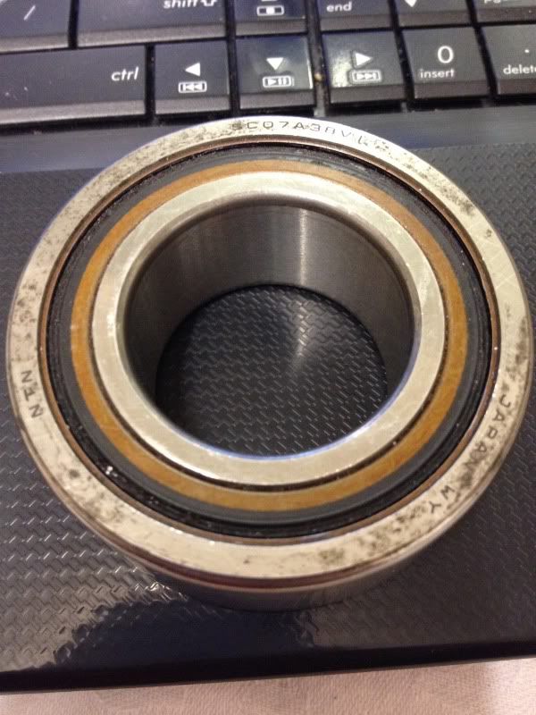

I am after a bearing which has odd sizes. It was manufactured by NTN but the last one they made was in 1994! I have tried various bearing suppliers and searched the internet with no luck.
Sizes are: 35mm ID, 65mm OD and 24mm wide
It supports the drive shaft:
this is the original bearing from the shaft pictured above
The closest I have found is 35x62x24, would it be possible to have a sleeve made and use this bearing?

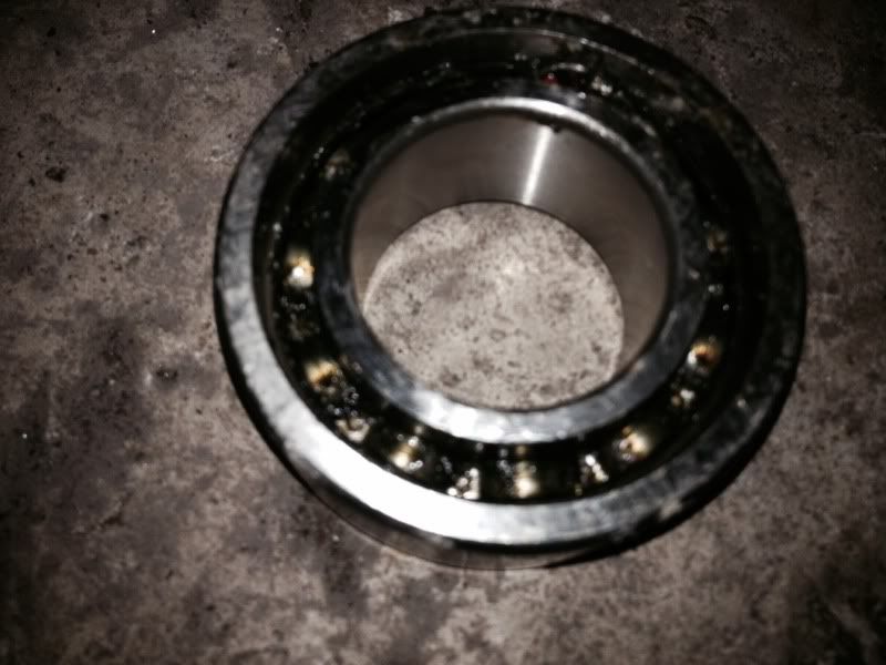

I have taken the seal off the bearing and it is a single roller bearing!

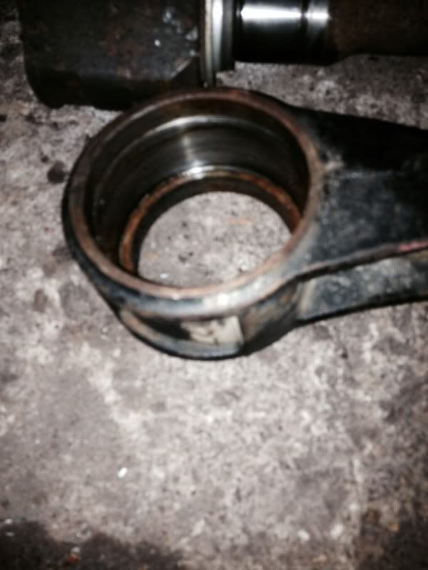

the housing it fits in:

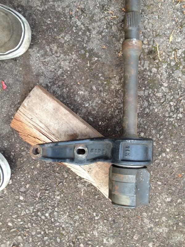

The driveshaft and housing:

I am confused as to why a single roller would be 24mm wide and have that aspect ratio. Did you pull the seals off both sides?
It doesn't look like there is any room to machine the housing, and as 65mm is a non standard od, you may as well look at 35id and 62od options.
Yes took both seals off, only a single roller. There isn't any room to machine the housing so I'll get a 35mm I/D 62mm O/D bearing as you suggest.

Is it a ball bearing or a cylindrical roller?
I guess I still don't comprehend why it'd be so wide. They had their reasons, but that is not at all obvious.
Final thing you can do is estimate the ball diameter, and number of balls, and compare the to SKF 35/62 size. And I totally reccomend a SKF / FAG / KOYO / NTN etc quality bearing. Personally - SKF all the way.

Ball bearing. I will guessimate the ball diameter tomorrow and have a look. Thanks
