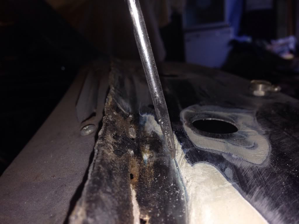

after the repair i did on the scuttle i set about getting the bubbling paint from the scuttle only to find out it was full of filler and was completely rotten and full of fibreglass bodge, so whilst i have the scuttle of i was thinking about the miglia type bulkhead box, has anyone got any pictures of there whilst in the making of one?
cheers
heres the rot and filler

Man that's some filler!

ahha i no was just goin at it with the grinder and just a load of white dust looked like a ghost

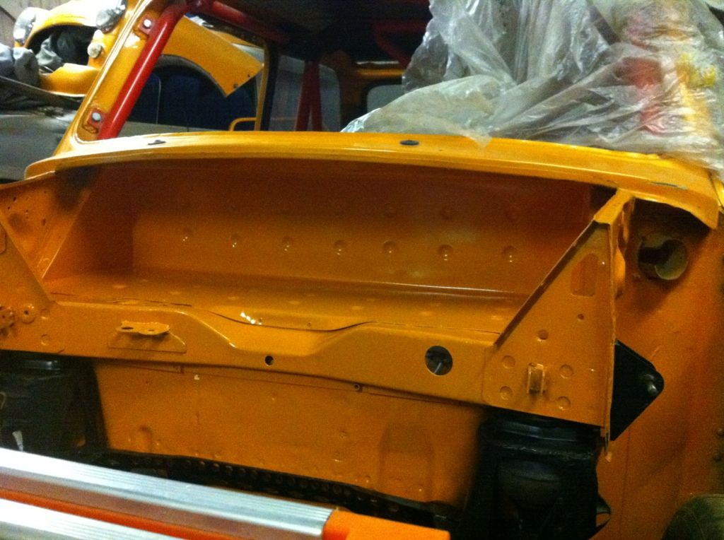

Found a real old pic of mine ...
Hope that helps mate
Rich

that looks class rich i would to know how to do those dimples

I bought mine off Ross on here but I don't think he's still on here. Oli's just gone dimple mad on his car

He's mine

cheers chris looks amazing, will have to get mine started when i get some supplies, should i do it in steel or aluminium?
Making it out of steel will be easier to fix to the rest of the shell.
