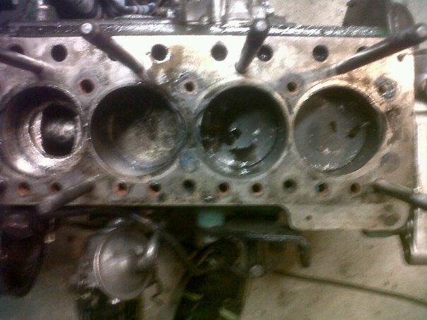

hi I was just wondering how many or you hav experienced a catastrophic engine failure. heres one of mine. feel free to add your own pics.

that's why you don't weld pistons this happened after around 200 miles after it was built

haha yip a sill idea from my brother (hes a coded tig welder) thy worked for a short time

welding pistons is just as mad as welding crankshafts and people do that all the time

If he's a coded welder he should of known better. Lol
I've heard of cam shafts being welded successfully before though.
Now that's a big hole!
Why did the piston 'need' to be welded in the first place?

yes the piston had a hole in it in the beginning. welded it up then machined it flat. also these are bmw pistons not mini pistons
also please note all 4 pistons are welded

What pistons are they? Got any more details?

thy are bmw k100 pistons they are perfect in a 998 or 850 as they don't need skimming but a was running them in a 1098 so thy required skimming

yes offset bored to 67mm

I machined the piston crowns to a could use them with a 1098 crank built the engine up and ran it did 396 miles then put a 10 mm hole in one of the pistons so I pulled the engine out striped it my brother welded the hole up and built the inside of the crowns up on all the pistons with weld re assembled it thn a did about 200 miles and fucked up as u see now

So this isn't an 'engine failure' it's a 'brain failure'????
theres your answer! above ........... plus a shade of deonation and too much CR maybe and trying too much!*frown*
Something must have been wrong in the first place to have gotten a hole in one of the pistons surely?
