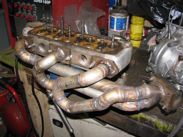

20th Jan, 2014 at 10:09:31am
Actually got into the shed for the first time in aaaaages.....

20th Jan, 2014 at 11:09:27am
not sure i understand the turbo placement?
113 Posts Member #: 9241 Advanced Member Edinburgh / Dumfries |
20th Jan, 2014 at 11:43:00am
Mmm the plate is kind of tempory to help align the tubes but as also bit of rough idea where the turbo might go.
20th Jan, 2014 at 05:03:54pm
That short centre runner will hit torque where you most need it.
20th Jan, 2014 at 05:15:13pm
I did consider making it more equal length but I ran out of bend.....
20th Jan, 2014 at 05:16:17pm
I'm not sure if I exactly know the reasons behind it..... maybe it shoud go and research it |
20th Jan, 2014 at 05:23:44pm
I made a similar manifold for my first 998 turbo in 2007.

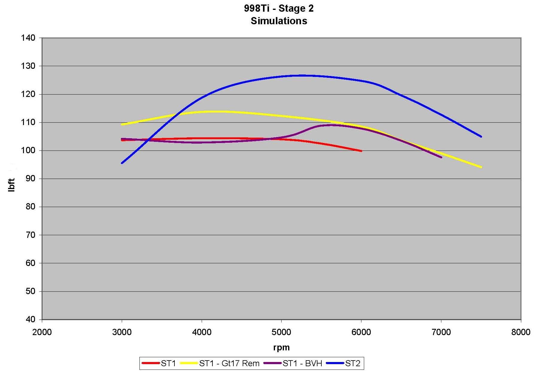

21st Jan, 2014 at 09:40:18am
This is a chart I drew up 3 years ago:
830 Posts Member #: 908 Post Whore gateshead |
21st Jan, 2014 at 10:25:42am
holy fuck. i guess just knocking one up to go in the elf is going to be a bit more difficult. there goes the sneakyness of not really noticing the turbo.

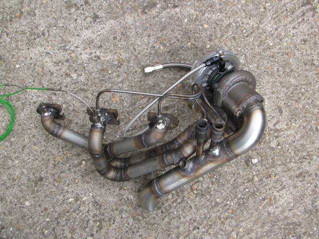

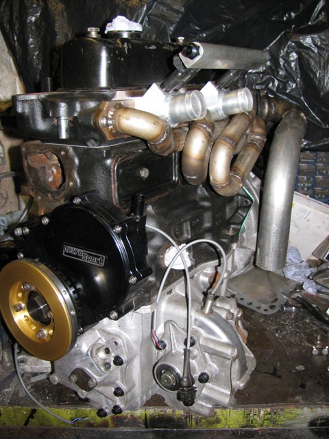

21st Jan, 2014 at 12:21:10pm
Pic of the manifold from the other side:
21st Jan, 2014 at 01:02:16pm
It does make for much better exhaust/ inlet piping routing too....

21st Jan, 2014 at 01:18:52pm
Which manifold is which Paul? Is the top one the Mig one that ran briefly and the bottom one the latest design? Fastest 998 mini in the world? 13.05 1/4 mile 106mph

![]() 9502 Posts Member #: 1023 Post Whore Doncaster, South Yorkshire |
21st Jan, 2014 at 03:38:47pm
On 21st Jan, 2014 wil_h said:
Which manifold is which Paul? Is the top one the Mig one that ran briefly and the bottom one the latest design? from what i remember of it the 3rd was on the Mig Yes i moved to the darkside |
