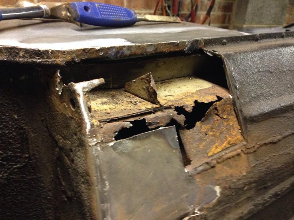

need some advice on welding this, ive got a welder but not very confident in myself to weld it, needs to be strong as its the rear subframe mounts! advice? or price for someone to come sort it? thanks

I would start by taking the oversill off and seeing how bad the rest is.
You can get a half floor with the outer sill etc attached. One of them and a heel board repair panel would sort that easily enough. Couple of days work to do it properly.

I spy over-sills. You should cut more of the sill back to make sure there's not more rust waiting... you need to cut ALL the rust out, not just patch over the top.
Get practicing on scrap first until you build up confidence and learn how to test your practice welds for strength. Sills were the first weld job I did. It wasn't pretty, but it worked.
Use Waxoil after your done. You shouldn't have to be doing this if the last person had Waxoiled the current sills

okay ill cut it back some more see what its like, im near sheffield, would like someone to come do it haha, i am wanting to learn to weld aswell though

First things first though, brace the door opening up and get the rest of that oversill off. See what other horrors are lurking...

Have a you got a half decent welder? If you start practicing on some scrap bits of steel it shouldn't take much the pick up mig welding. When welding thin stuff you have to use a bit of a 'pulse' kind of style instead of just holding the trigger in and going for it.

I learnt by going to a local fabricators and getting some of their scraps then taking them home and practicing. Trick is to make sure it sounds like a fry up cooking (I wrote down what settings I used on different thicknesses as well). Get a decent mask cos the ones that you get with the welders are fckin useless.

fed up of it been like this now! haha, looked inside the sill and the rest looks okay! wanting a price for someone to come and weld it back together please!
I've too much on to offer to do it. I will come and give you advice on what to do if you want, PM me.
I would say it needs a heelboard repair panel then a repair to the sill as a minimum. But if that side is as the picture, what's the other side like?
