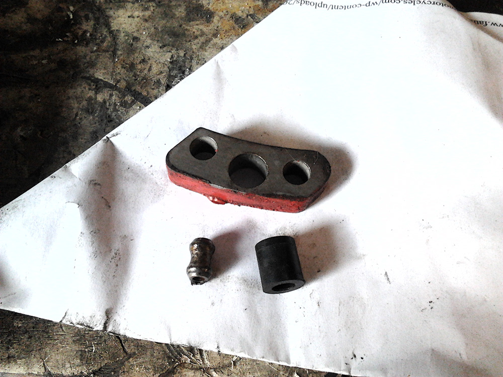

I found that the rightside brakecalliper was leaking.
I run a vented metro turbo set up.
So I ordered a rebuildkit thinking everything I would need would be in it.
Ok, I red the part description wrong so I am missing some parts.
Mini Spares does not sell the rubber that is inside the spacer between the two callipersides.
Has anyone an idea were I can find these????

Not the same as MGB I'm afraid, we have tried quite a few times to get these made/sourced.
TurboDave16V
Hmmmm...
Perhaps you need to make a new spacer that allows you to used the standard caliper square rings?I can't see how to safely fix what you have right there.

How exactly does that work ? Is that s spacer or something ?
What does the little nipple thing do in relation to the rubber ?
9.85 @ 145mph
202mph standing mile
It seems you have two options:
1) chuck the calipers in the bin and buy some new ones (not that cheap, £350 for the Minispares alloy ones plus the spacer kit)
2) Try and modify the spacers/calipers to fit 'O' ring seals
The spacer is there in case you you use the metro 4 pots on vented brake disks.
Vented disks are wider than solid disks.
The steel nipple is there to keep the hose in his straight form, it prevent it from deforming.
I already thought about option 1, it is always an option but I thought more people are facing this problem so perhaps I can copy their solution *happy*
I going to have a look what can be done with the standard parts to make them work with O-rings.

10022 Posts
I imagine the majority of folk just use later Metro calipers which are cast to suit vented disks.

Yo-Han
975 Posts
Member #: 3228
North of the Netherlands
Minispares actually has the std calipers too, for 120 quid each

15300 Posts
Brakes International Rochdale list recon vented calipers in stock £77 each

Hi Paneelmeel,
Just google on words "seal brake caliper spacer" and watch pics.. you will find enough places for these square O rings. I have some in stock here (in Holland *smiley* but just as spare for my own vented Metro 4 pots and vented Princess 4 pots on my MGB V8

I use a place up in Sheffield to make any type of gasket you require, tell them
The application, some details on groove dimensions and they will make you some. They are called DMR Seals. I use them all the time for oil and gas valves, pumps etc that don’t seal or you cannot get seals.
They aren’t expensive either.
