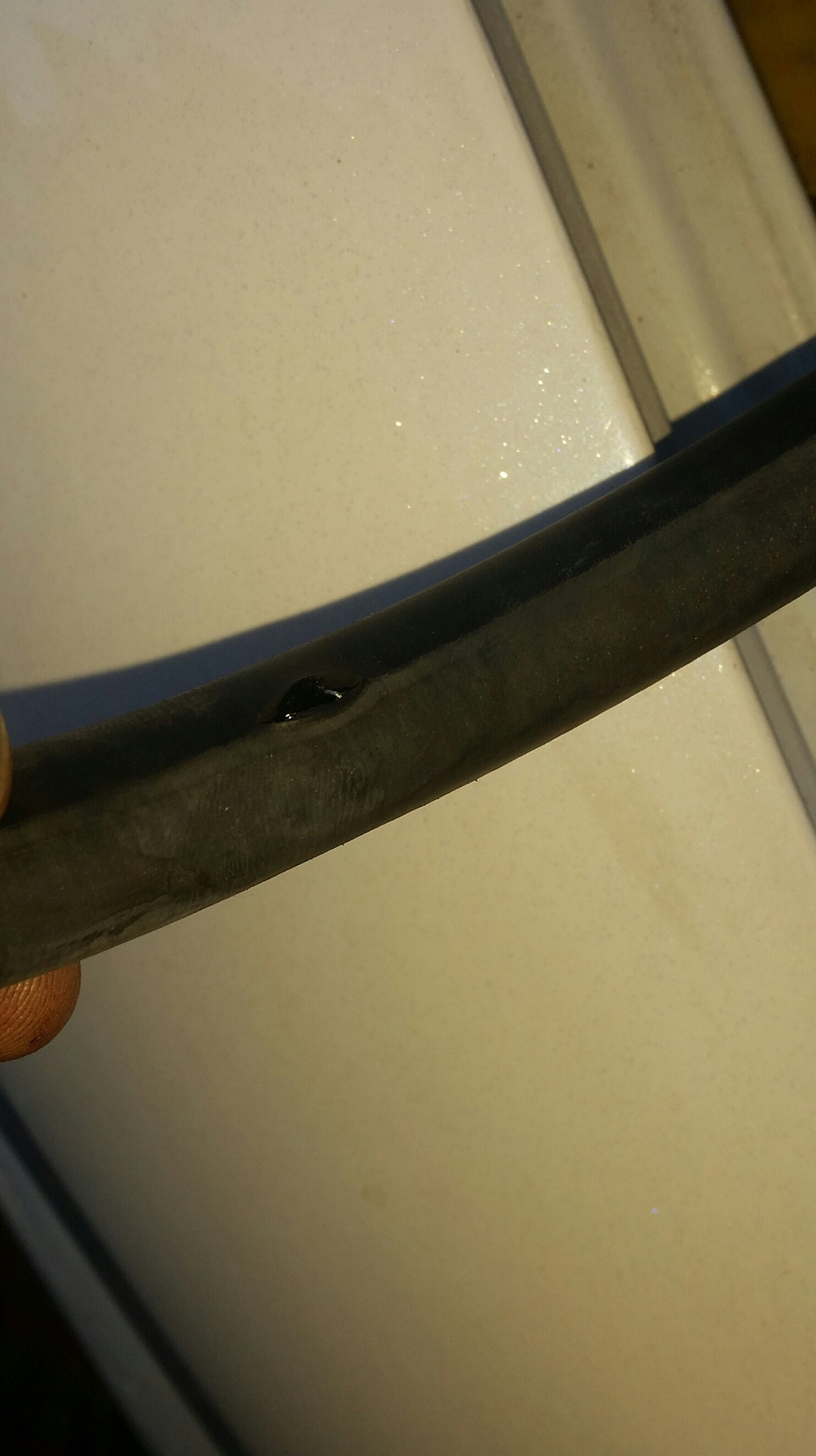

I had a similar issue bot long back whilst working on the skyline i found a perished hose.. not leaking as such but looked bad
I didnt have any around in the correct size so i nipped out to the local car parts shop and bought 1m
Replaced it and thougbt nothing about it
The following week ( after zero miles) it split when i put the ignition on it pissed fuel everywhere
The pic is the 1 week old new hosing... after it split i checked iver the rest of the the pipe in the shed.. no markings at all
i always use the goodyear hose normally but had non
Edited by Brett on 9th Oct, 2016.
Not surprised it split. Using normal crap hose on EFI is just suicidal.
You MUST use proper EFI rated hose for any EFI install because of the pressures involved. Although it's almost as shocking anywhere selling fuel hose would even stock crappy stuff anymore that isnt rated for EFI pressures given it's the most common fitment these days

when you walk into an auto parts shop and ask for 1m fuel pipe ( this is the kind of place that NEEDS a number plate to look stuff up )
you just dont expect to get shit........my own fault for not checking
luckily no harm done
