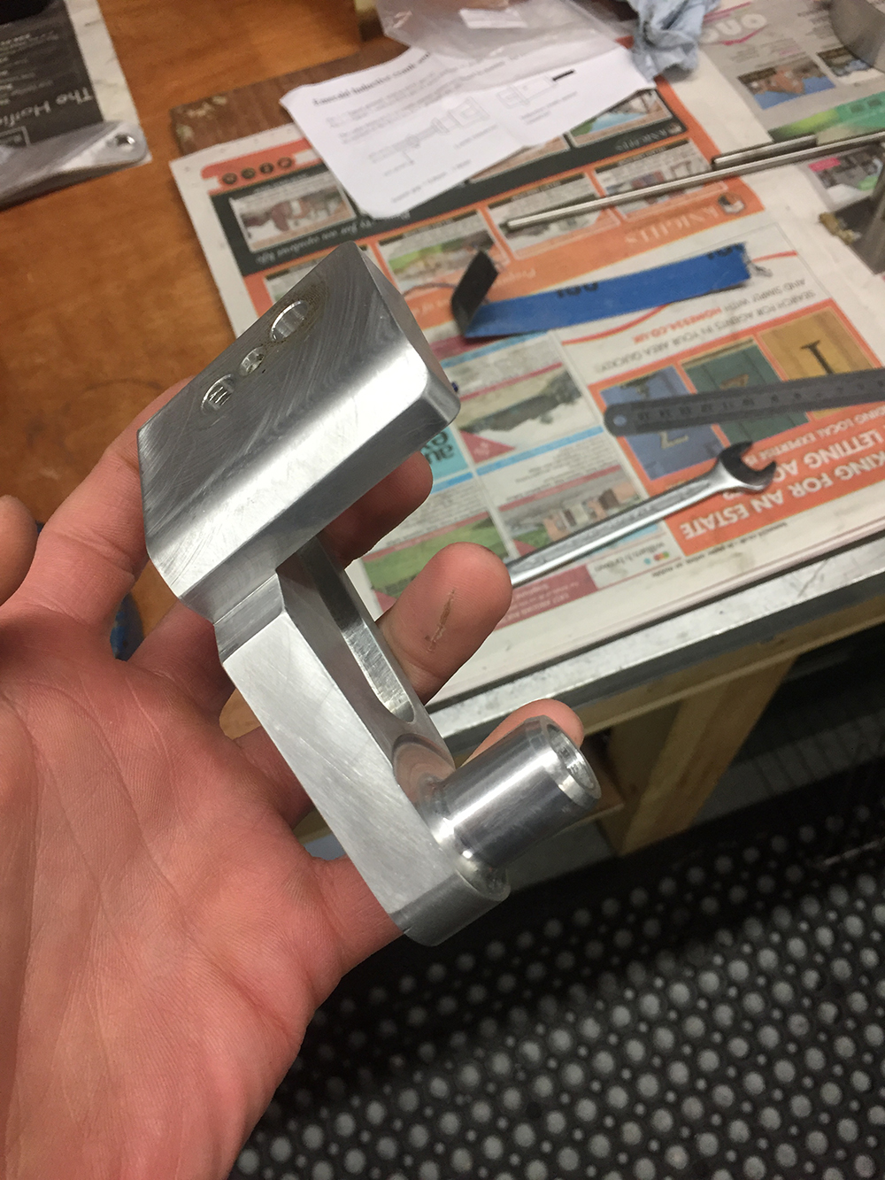

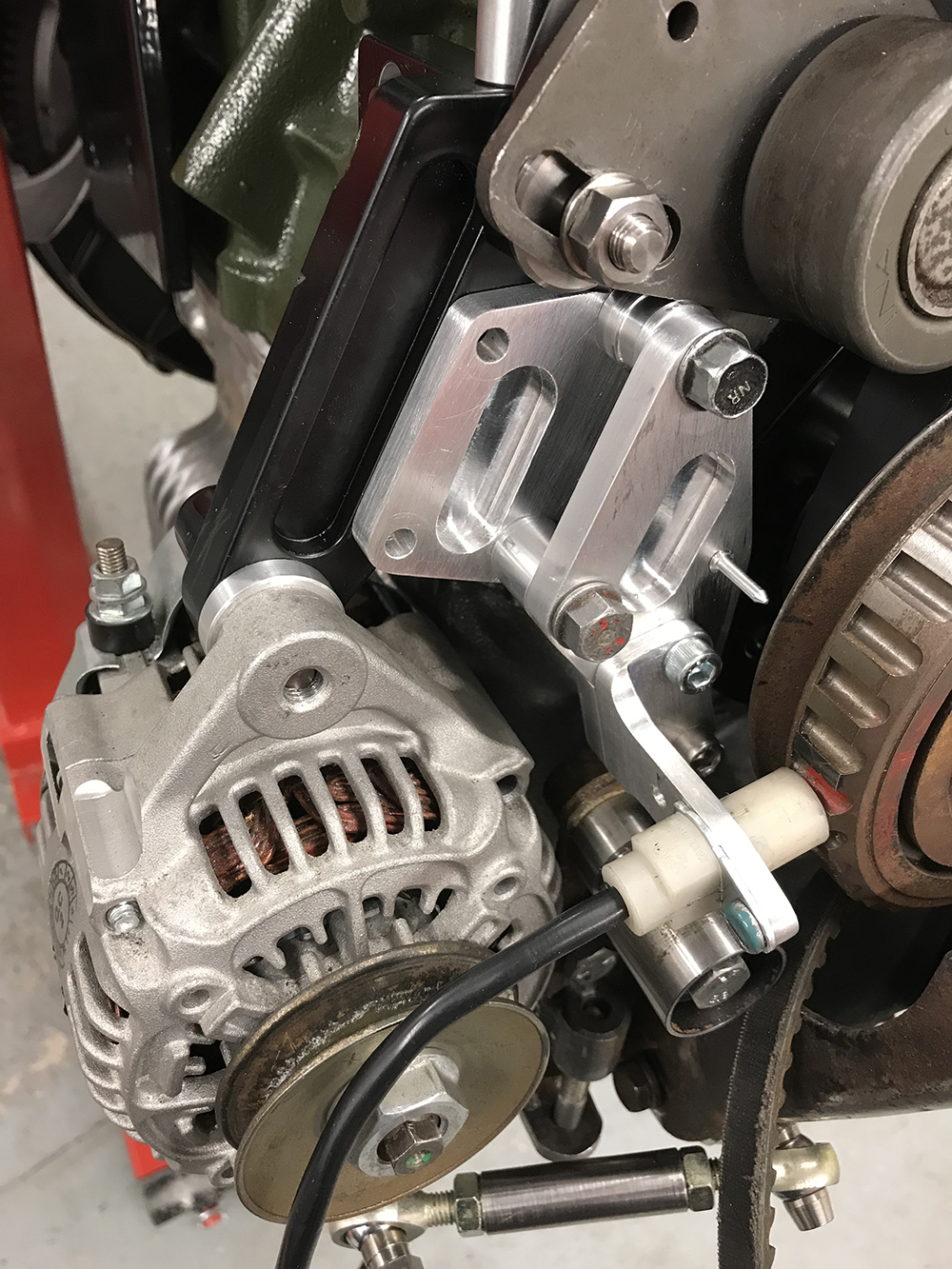

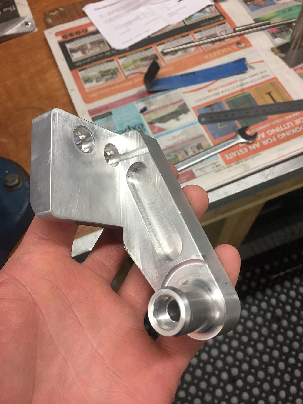

This was my resolve for using the Mpi block and mounting a denso.
Shane

Wow, you’ve spent a long time whittling that out of a solid lump of ally!!!
Shane
that lower alternator mount is beautiful, probably a lot to ask but any chance of another! Haha!

Wow, you’ve spent a long time whittling that out of a solid lump of ally!!![/quote]
Surprisingly not as long as you’d think, you can remove large amounts with it set in the lathe four jaw and then with a “ripper” cutter on the mill.
Shane
Where you running a front mount radiator?
I’d happily machine another but my spare time needs spending on my own car as it’s been off the road too many years.
A similar bracket could be achieved with steal plate and a welder tho.
If your running a standard timing cover this idea would need some adaption due to lacking the use of the holes that I’ve used for the cps bracket which ties into the alternator bracket
Yes I have a front mounted rad and have considerably less space than you have with no bodywork being cut or additional holes being drilled.
