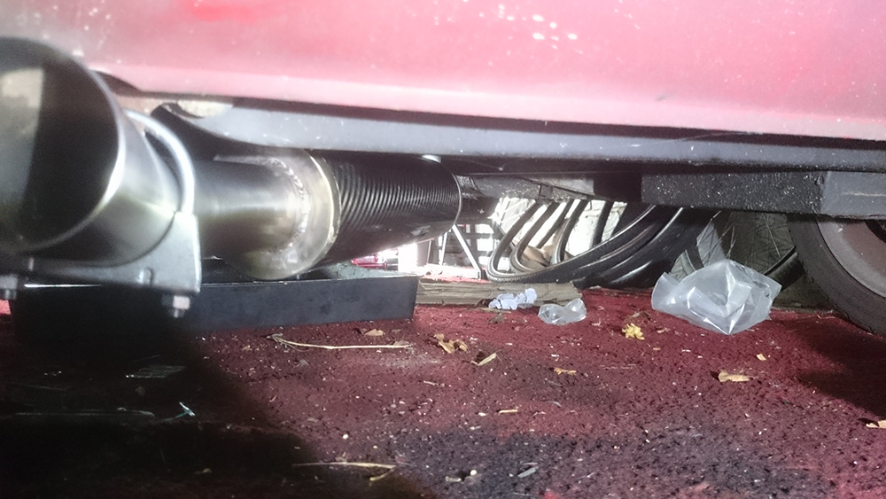

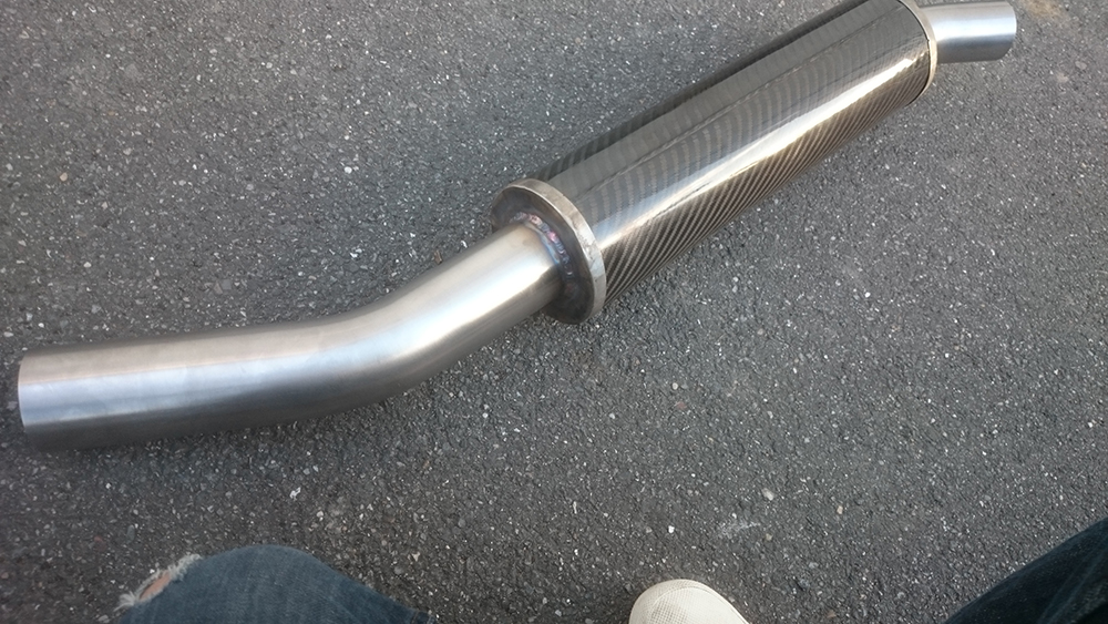

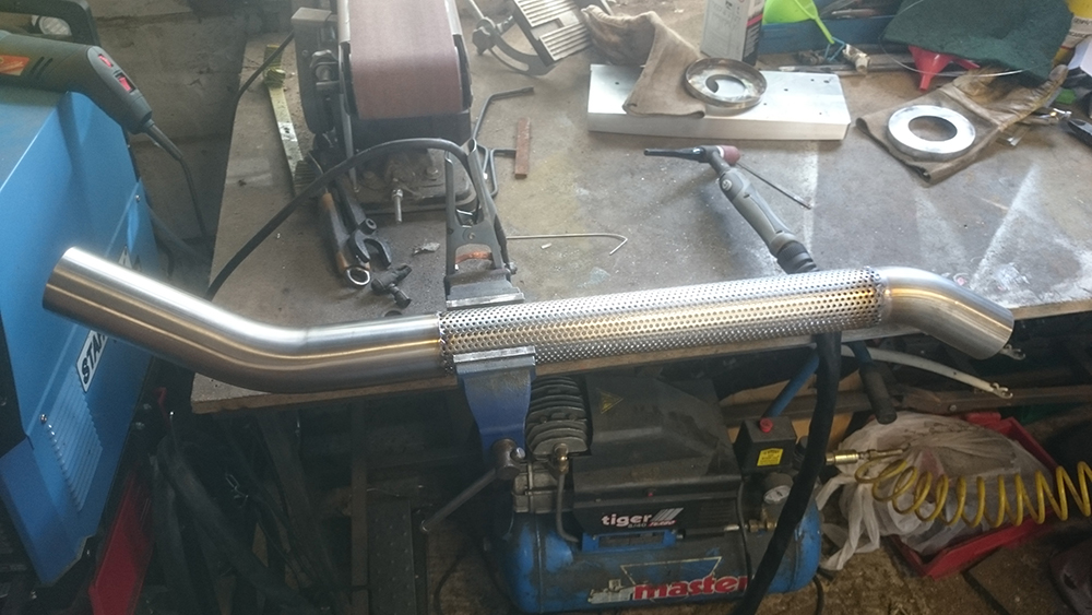

Sounds doable,
I built a rear box approx 40cm long with plenty of room to spare, I used a pair of 30 degree mandrel bends, some perforated tube and the outer from an old carbon bike can and a pack of wadding.
I think I used a 2.25" bend, then 2.3/8" perfotsted tube then a 2.5" bend to they all slotted together before welding.
