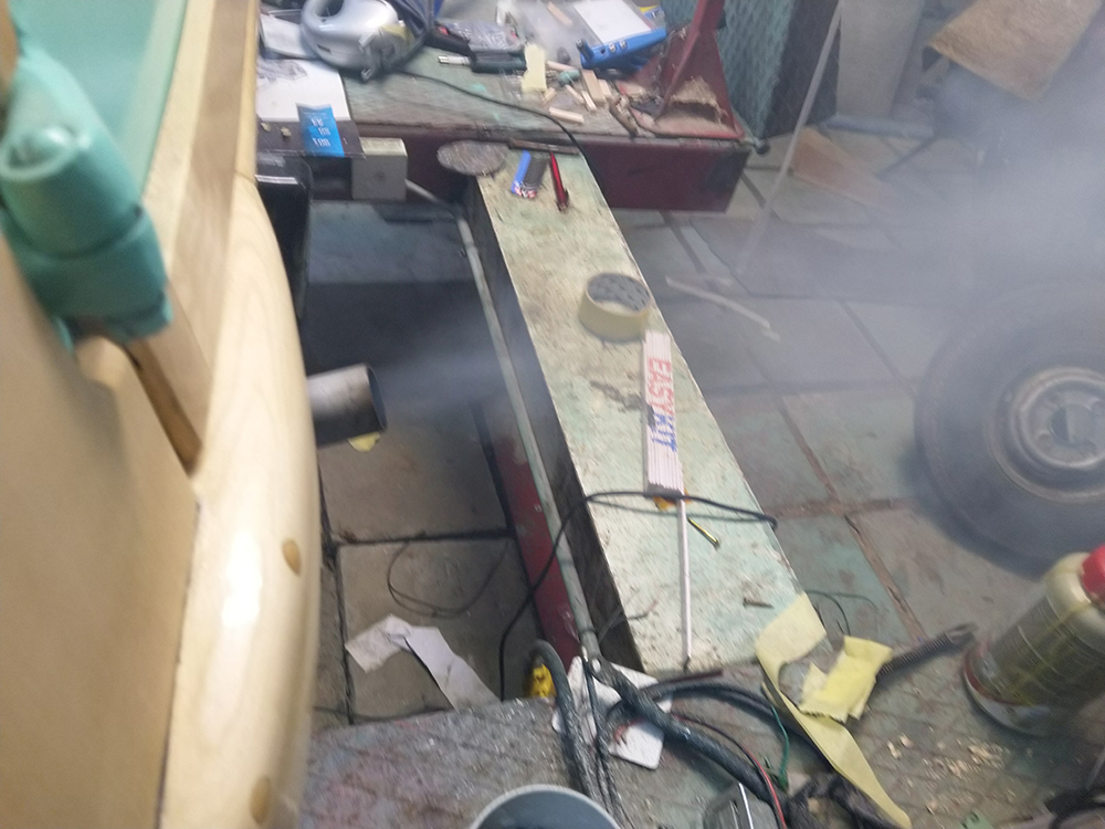

So. Fully reconditioned head ( new Guides correct play valves laped in new oil caps ( the Brown ones) but still there problem is not solved.
It smokes so bad the neighbours toyght my garage caught fire.
Toughts?
Oil pressure is good. Engine stays Nice on temprature and compression is a solid 160 ons/square inch on al 4
Edit
Sparkplug 2 3 and 4 are soaking wet and very dirty.
