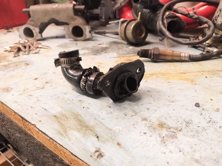

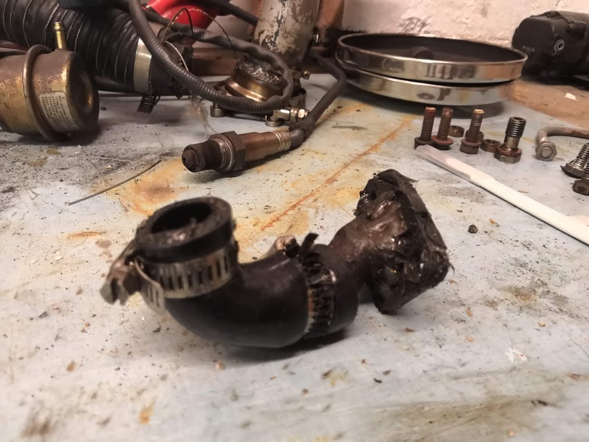

Need a bit of advice with oil drains. GT1752, home made manifold.
I've just taken the high mileage Saab turbo off to replace with new chinese turbo (max speeding rods), to hopefully cure the oil smoking.
I didn't do the oil drain - my mechanic/mate did, and I can see now it's off, that it's really not a great attempt.
The first pointer, is that it was full of oil when I removed it! Oil doesn't freely go uphill apparently..
Part of my issue is that the turbo on our home built manifold sits a bit lower than Metro/fusion manifolds. So, it's more across than downhill to the fuel pump blank.
Is there anywhere I can drain back to easily that's lower than the fuel pump blank? Without splitting engine/box and drilling holes?
If not, I think I can possibly make something slopes straight from the turbo exit, rather than using a 90 degree bend, which is then too low and has to go back uphill.

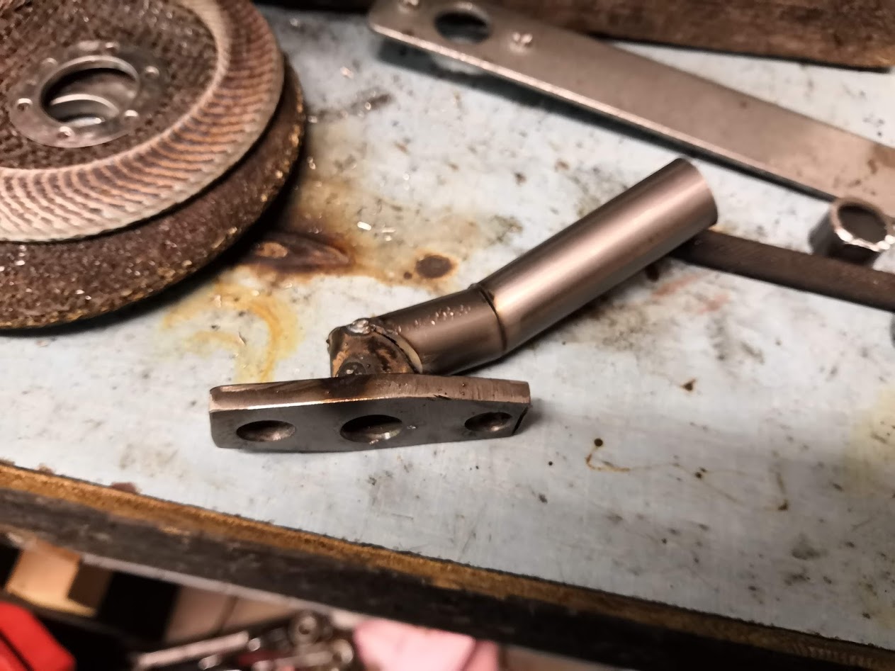

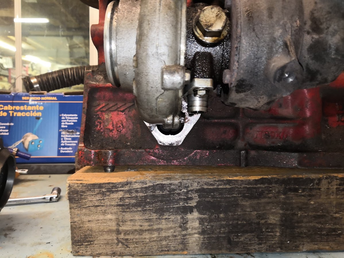

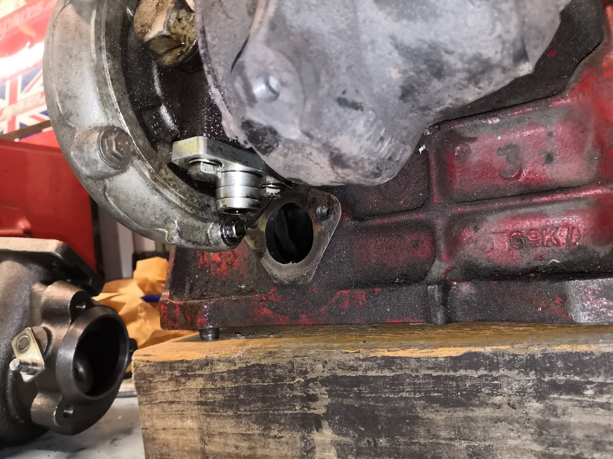

So, I've got it on the bench, and there is a drop to the fuel pump hole, just not a huge one.
I've started mocking up a new oil drain, just got to work around the coldside casing of the turbo, so it's a bit of a strange shape - but, won't have any "uphill" or "flat" sections.
Do you think this will be free-flowing enough? It's 16mm tube. It will attach with a small link pipe (silicon) to a 16mm pipe welded to the fuel pump blank.

Just to pinch back a bit of space, can you make that flange onto the turbo core thinner? Looks very thick.
stevieturbo
3597 Posts
Member #: 655
Northern Ireland
Why not go from that alloy base, to say 19mm directly into the block ? Looks like you could get an almost straight shot at it and maybe even with a little downhill slope.
ie weld the 19mm alloy pipe to the existing barb.
