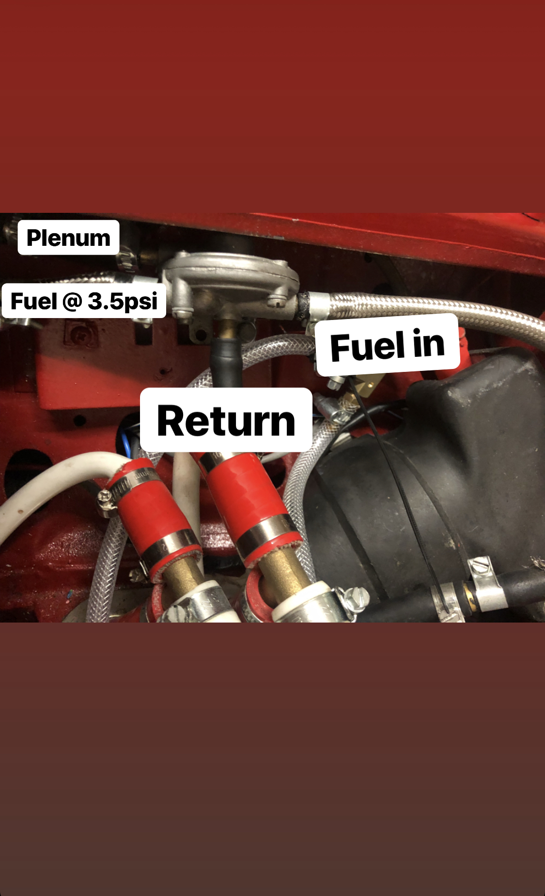

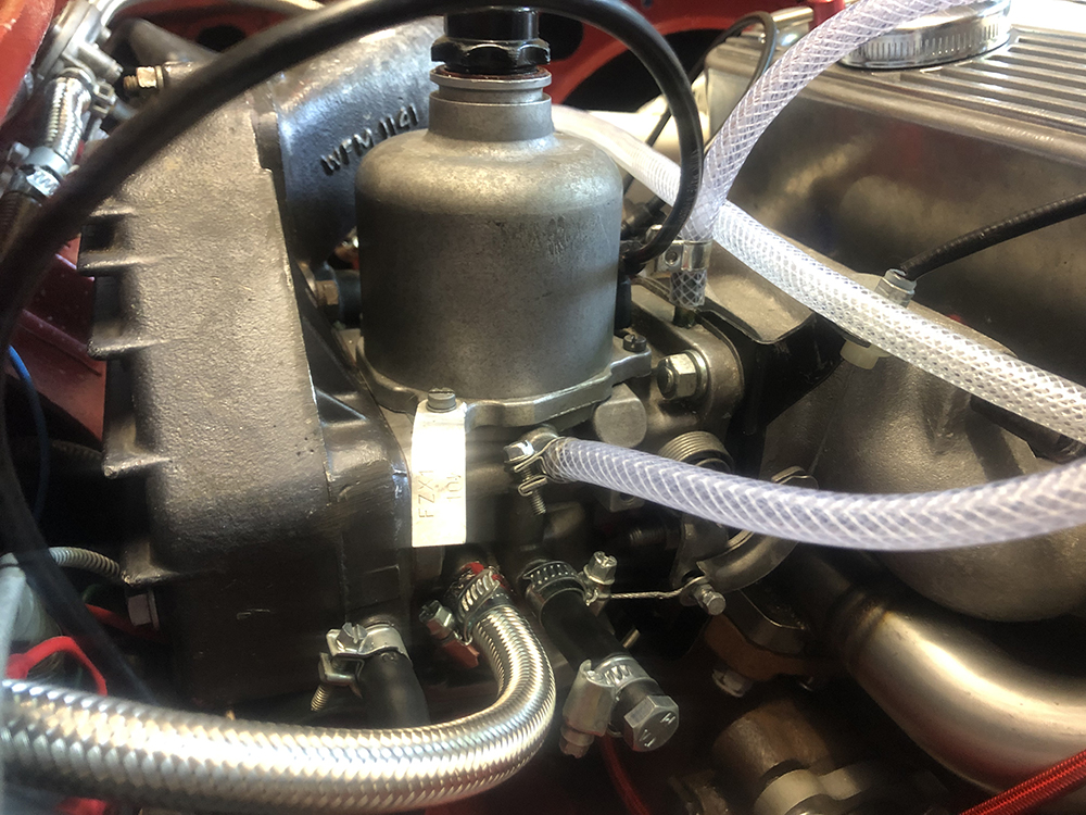

Attached a picture of my carb connections, getting fuel up to the carb but not the other side?
Plenum to top of fuel regulator
Braided hose is fuel in
Other two are blanked off
Plenty of choke nothing - plugs dry as a bone
Easy start down the intake nothing
If I remove one of the blanks and the blank on the inlet manifold and spray abit of easy start down there she runs 🤨
But still no fuel getting to the plugs
Any ideas

T-piece won't help in this situation. Normally I'd suggest your float valve is stuck shut, but as easy start down the throat won't work are you sure your carb piston is free to move?

yep moves freely, was stripped and cleaned
funnily enough have just checked the float valve, and gave it a little adjustment that puts it just before it overflows
t piece didnt work so back to square one!

4642 Posts
Pictures of your reg connections would help. There shouldn’t be anything at all blanked off on the reg.
Phil.

Will do when I’m back
It goes
Plenum. .Fuel in
Fuel in
. Fuel return
Edited by Will on 10th May, 2019.

3.5 psi at the carb end would lead me to believe the Reg is ok
(But real test is rising pressure with boost right?)

If you remove the plenum does it start then?
I am wondering if some of the holes are blocked between carb/plenum.
How did you get the 3.5psi?
I always put an inline gauge so the carb is being fed whilst measuring it.
If your carb is blocked, this setting may be incorrect.
