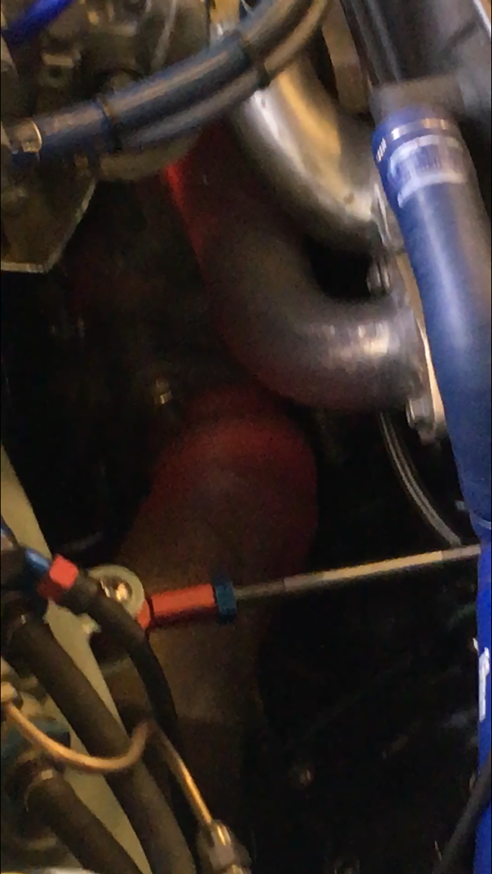

I’m planning on fitting one because my turbo will be side mounted. It’s not running yet so can’t tell you if it’s any good or not.

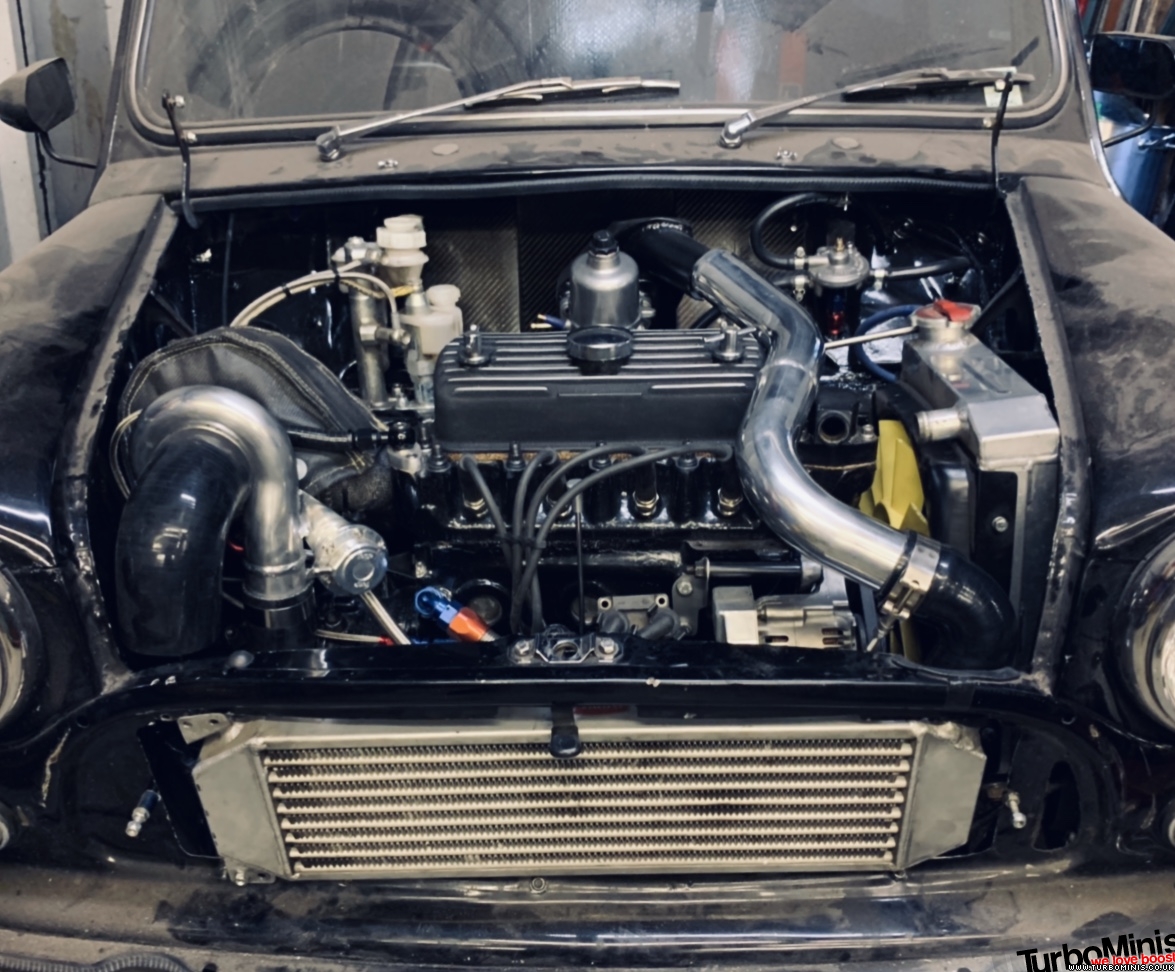

Very neat and tidy.
Are you running a gt17? I can't find a blanket sold as a gt17 one. Thinking one for a T2 would fit though?

I think my blanket is for a T2. The turbo is a TD04, pretty much the same size externally as the 17.
