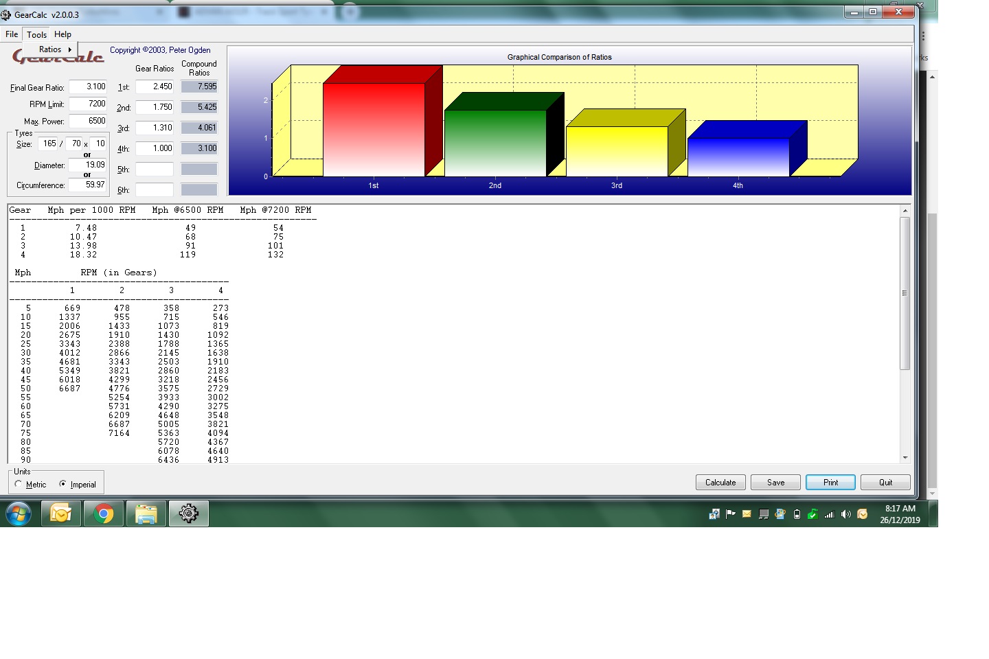

My 3.1 does 121mph at 7200rpm.
3.1 on a 10" tyres seems to work out much higher johnny ?

Strange, i must have messed up somewhere! I will check. Perhaps i am using a 3.2.
The speedo is GPS and rev limit is set at 7200 on the ecu. You can hear it nudge the limiter here at 3.18. https://youtu.be/p_Qtj-IR_H4?t=199
Maybe even a 3.44 ?

No definitely not that high. Doesn’t seem to tally up though. I shall work it out.
