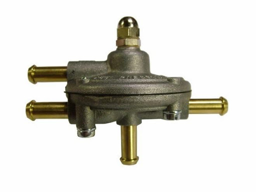

So hopefully the picture I have attached works. Its the regulator that almost looks like a UFO😂
Unfortunately it doesn't have a gauge attached so I'm unaware of what pressure it is putting out.
The boost gauge to plumbed into the manifold and t pieced with the dump valve as per a image off this forum. Like I said it doesn't seem to have any leaks that I can hear and it sounds like it's trying to build boost as the dump valve opens and releases pressure.
As for driving problem, I seem to reach about 3500/4000 rpm and it holds back. Like a N/A engine that isn't getting enough fuel.
Hopefully that helps a bit better
