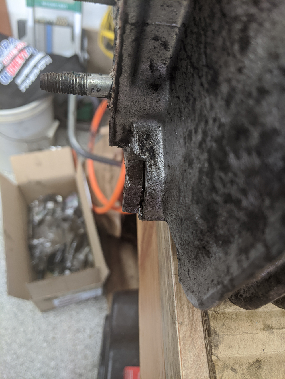

its a 998 from teh 80s. When I got the car it was stripped, so I got the correct helicoil and drilled/tapped it, no issues...except for the fact I didnt do it straight, not my proudest moment. It happens to the best of us.
So its off to the point where only one side of teh seal contacts. If I really crank it down it gets close to stopping, but it still has a drip.
Thoughts on repairing? I was hoping (which is a crap shoot) that i could pull the insert out, stuff the tap back in and run it in straight, yeah the threads would be wierd, but maybe I could get the insert in straight? Thoughts on getting the plug in straight? Motor is out, gear box is off and its getting stripped down to rebuild soon. When I got the case empty I wanna get this right. I can do it straight now that its on the bench.

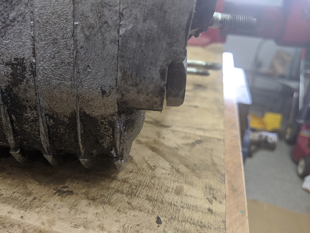

I got the gearbox torn down and really looked at it. Looks like I can shave the wind off around there the sealing surface is so I can just flat file the angle in. In the end if it's 1 deg off and seals flat who cares. There is so much meat in the area I'm not worried about it. And if down the line it's really an issue it would have to be plugged, welded and machined flat again anyway. Should take me less than an hour I think and the repair should be fine

Fixed! Cut off the ears around the drain plug so I could get a flat file on it, then just filed an angle into the sealing surface to match the angle of the drain plug. Didnt take much, tool all of 30 minutes. Done and done!
