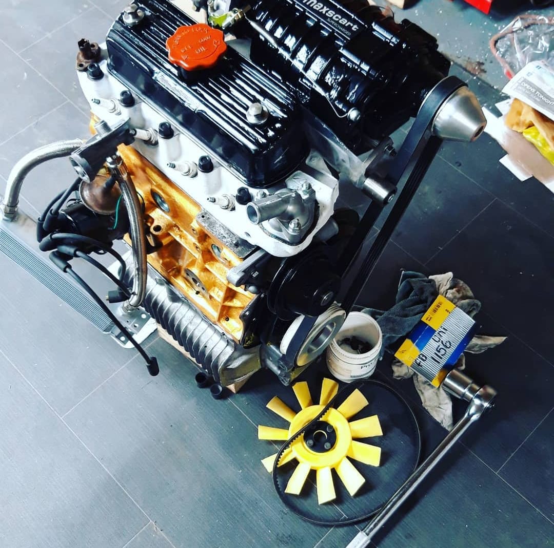

Hi can anyone help me out? I purchased the vmaxscart supercharger kit 12 months ago and the belt was rubbing on the frame without realising. The belt snapped and need a new one but not sure of the size? I have emailed and txt Stewart from vmaxscart buy still no reply 6 months later. . . Does anyone know the size I need?

Usually there is some information on the belt.
Alternatively measure the length, count the ribs and google (length in mm's could help)

I have the packet it came in but no longer have the belt.
Problem is I can't find the code on the packet anywhere, so been questioning if that is the size
FB UNI 1156 is what is written.

Could 1156 be the length of the belt in milimiters?
Easy to check with a piece of string
